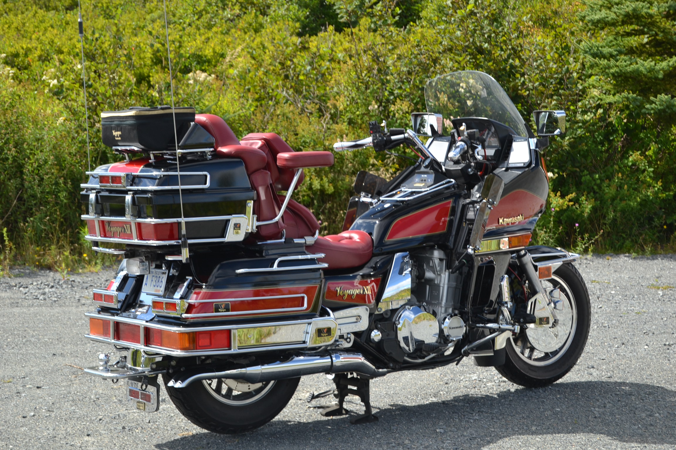

Re: Replacement panels / graphics /Stickers 1985 Voyager 1300
On the Voyager XIIs the minor panel colour was sprayed on the area to remain this colour of the item being painted and then covered when dry with a blank out panel.
Next the field colour was applied to the remaining surface of the item being painted except for the blank out panel area.
Then the blank out panel would be removed and the cut line between the 2 colours would be covered with a decal before the clear coat was applied. I suspect the ZN1300s were done the same way.
Just recently I sanded the minor colour, teal in this case, and the black field colour right up to the dual stripe decal but did not sand the decal nor the clear coat covering it as I did not want to go through the trouble of trying to duplicate both the style/colour and position of the decal. I then taped the decal using 3M fine line 1/8" vinyl masking tape and 1/4" regular masking tape to bridge the uncovered portions of the decal before respraying the 2 colours. The Fine Line is amazing tape, only .13mm thick (.005") and it will follow the tight radii of the decal around the minor and field colour areas.
Having said that, if one was to sand the decal off entirely, with a method of positioning a replacement decal/pinstripe tape close to the original decal's position before sanding it off, there are suppliers who specialize in rolls of pin striping such as stripeman.com that one could use to approximate the original decal.
The tricky part of sanding off the decal is getting the location of the decal as close to the original position as possible using a blank out panel for each shape.

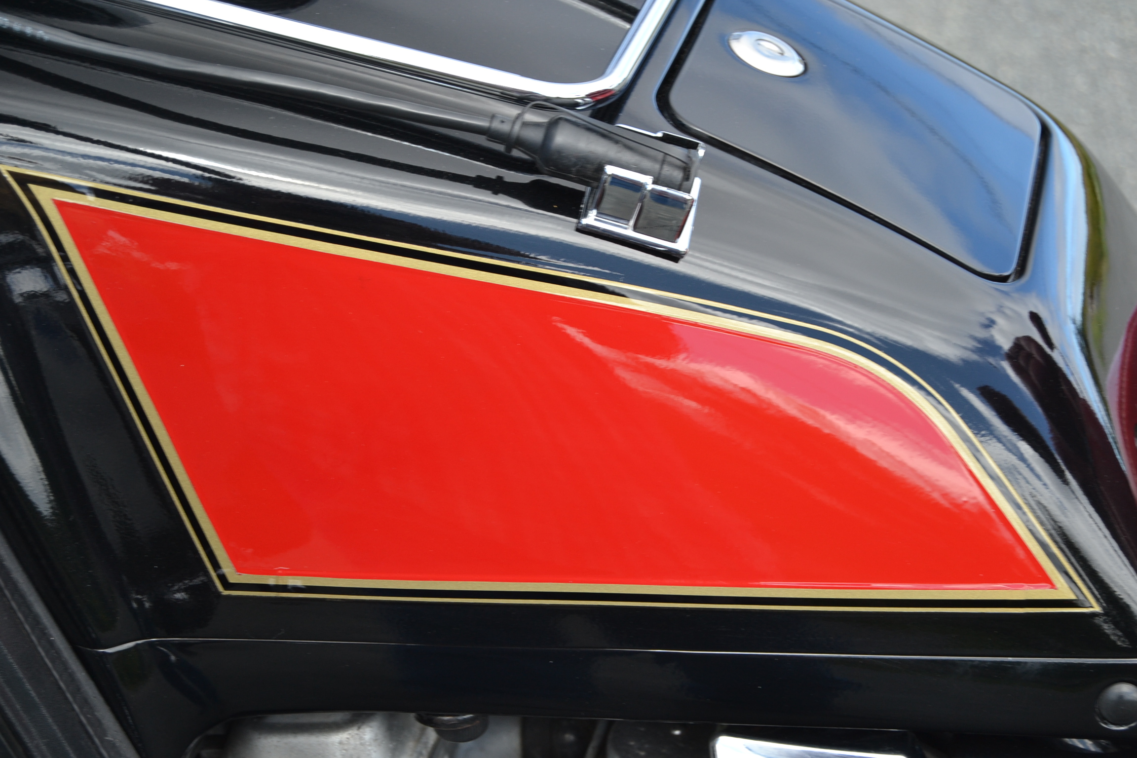

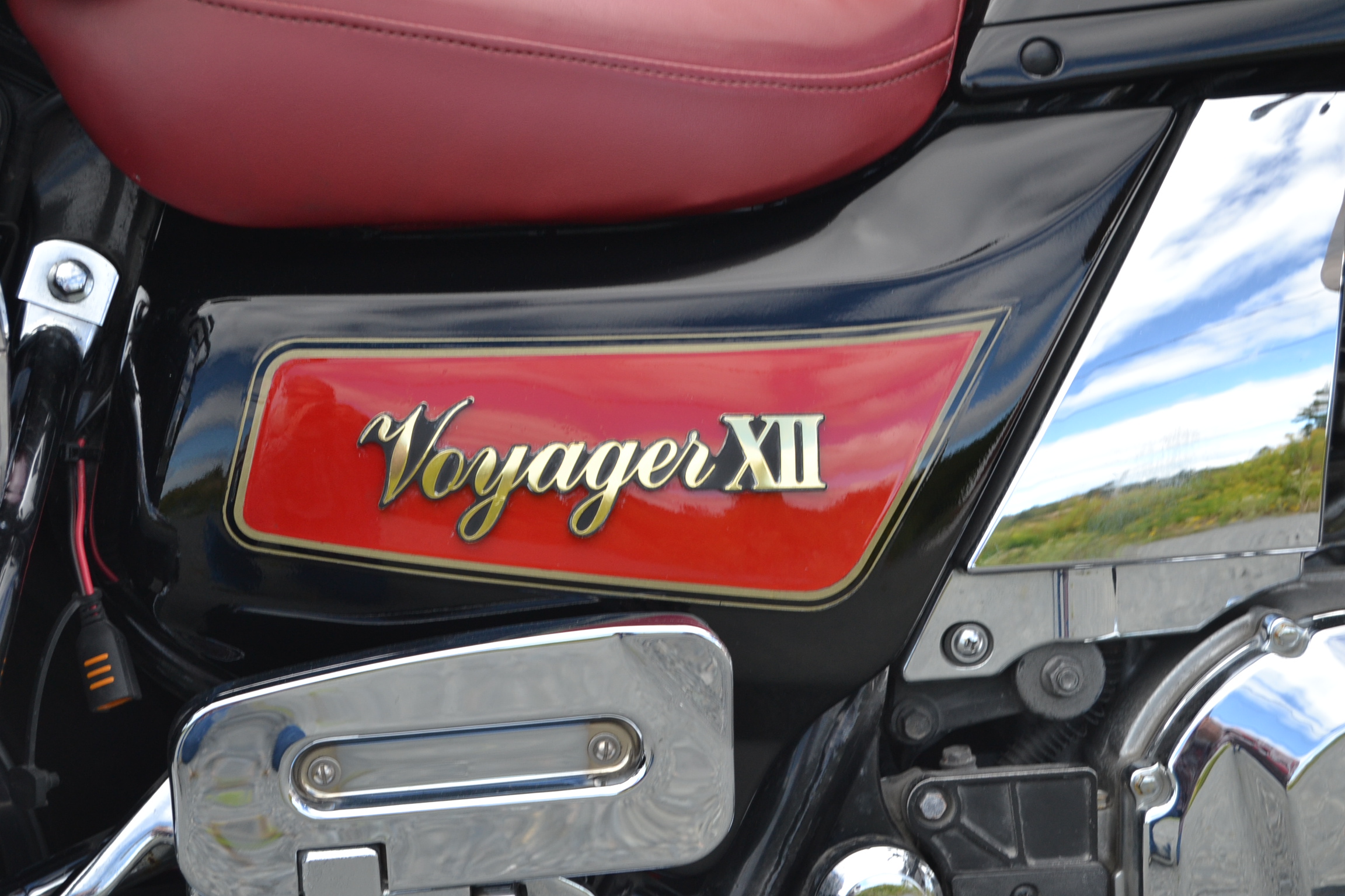

Here is what a sanded up to decal will turn out like, and the finished product when assembled, if one takes the time and sands carefully, and any worn/faded paint job can look good again a so long as the decals are in good condition.
I had several repairs to the decals I had to perform due to gouges going across the surface of the decal and by prefilling the gouge with epoxy and then scratch/dent glazing compound, I was able to colour match the black/gold and the repairs are virtually invisible.
