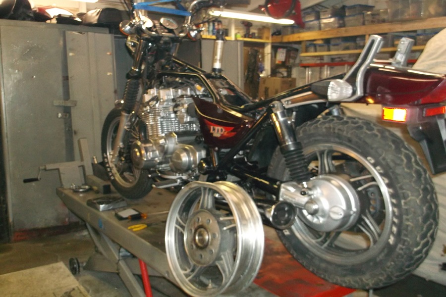

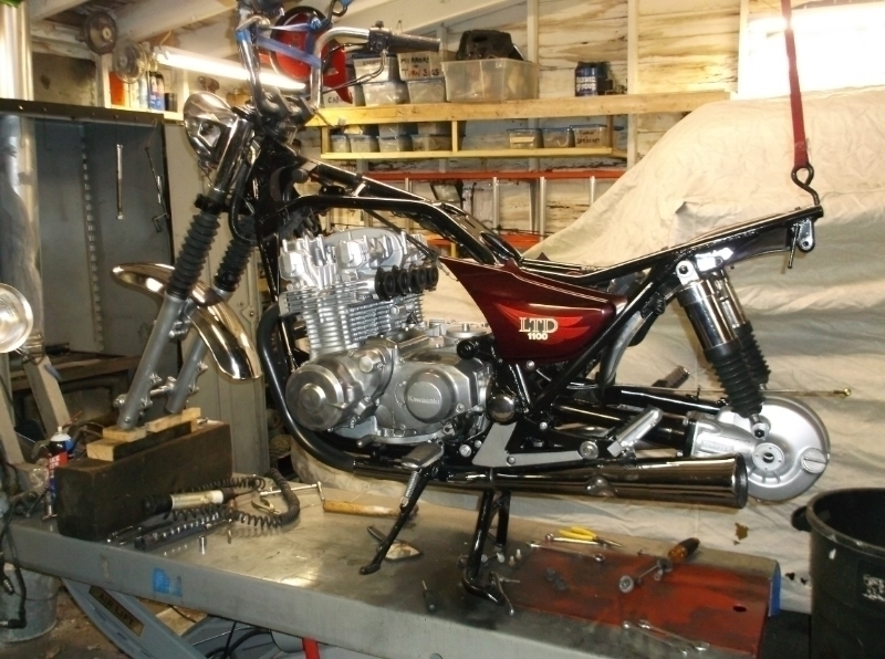

....So .picking back up on this old post....this is what I have been doing since I got the "BEAST" back together nearly a month ago...... This bike was in need of EVERYTHING.......
my plans for this bike is to get it looking as good as possible and running GREAT !
Then.....memorial weekend 2015, I will load it up in the back of the panel truck and take it out to
put-in- bay island where the 1970's cb 125 Honda has been stranded now for a long time. and swap em out.
bring home the Honda and leave the newly re-furbished 1100 shaft for good ,so that Pam and I don't look like (as she puts it) "dumb and dumber".....with the 2 of us on a 125 :gig:
here is some pictures of the progress.

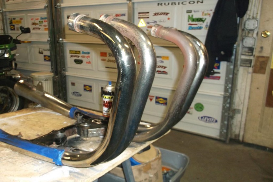

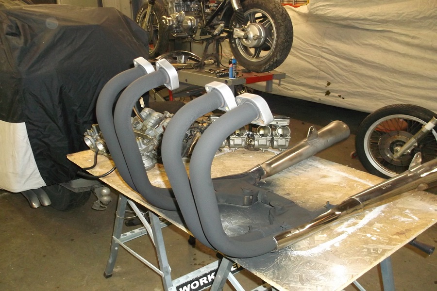

This set of pipes ,are from a older 1100 shaft that I used to own, but I told a buddy that I would put my 85'pipes on his bike till I was ready to have em back.. cause his cross-over tube was rotted out... well..... looks like I'm not getting MY pipes back ! so I made these ones look as good as possible,for spending no $.
for a 85' that was totalled.....and sat outside of a barn,on the edge of a soy bean field from 1985 til 2012.....the ol' girl is looking like she has some new life ahead of it !
This is a big project that will keep me bizy for at least another month....cause when this one gets done ...I still have to get started on "little sweety"...............to quote my friend Gene Kap.
"a bizy man is a happy man". :gig: well.....I'm HAPPY ! :gig: ................tony :-D

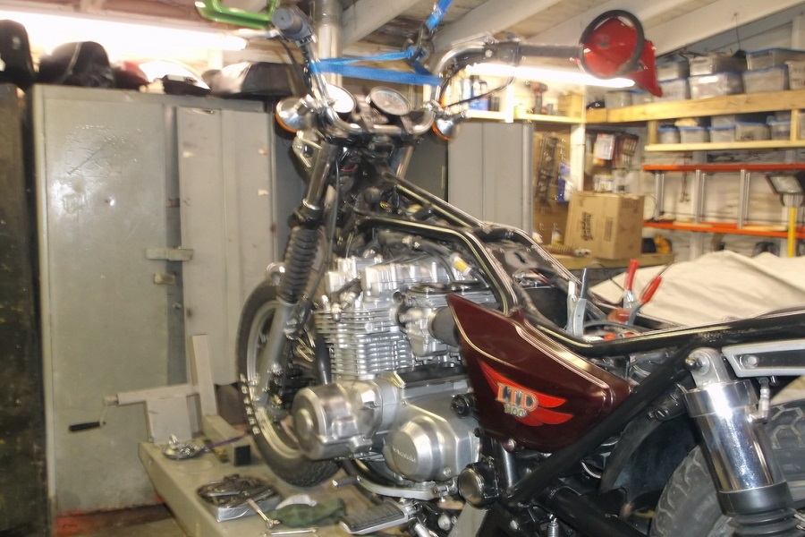

.....So moving forward....let's hear it RUN ! checking ALL of the engines "vital" signs...
all systems are GO !.........We have timed spark, fuel,and great compression :clap: ......
but then...I lost spark...straight across the board :dm: after doing my checks....the I C igniter decided
to retire.... I checked ebay for a used one, and as of a couple of weeks ago...there was not one to be had!....just for "grins and giggles" I checked availability of a new one(as if I would pay that anyway)
N/A................ remember... this bike is gonna be left on a small island,in the middle of lake Erie, and only rode (maybe) 4 times a year, I fabbed in a IC igniter from a KZ 550....and re-gained spark.
Of course... this was only for testing purposes, and I did not try to start the bike like this ,cause they are NOT compatible creatures.
So off to my many cabinets of M/C parts ....I decided to play around with the idea of a hybrid ignition system.....
After testing ,and exhausting all possibilities....it is apparent that the "triggering" function of my IC igniter decided to retire :hot: ........So.... in keeping with the "let's spend no money " theme of this project...... I am triggering the spark with old school points and condenser ,from a Z-1 :thk:
......popping a nice bright blue spark ,and all is good in "sparksville USA" :gig: Some of you may be wondering how I got a Z-1 timing advance unit to adapt to the end of a 1100 crank... and how that all went together,after removing the pulse coils and hogging out the un-needed stuff (aluminum stock) that lied within,,,,,but thats a whole nother post :tired:

.......A touch of the starter button is NOW bringing this 30 year "sleeping beauty " to life :clap:
BUT.... that did not happen without addressing a BUNCH of other issues ! remember... this bike was totalled by a insurance company ,back in 85' when it was new.
I have in my possession a 80' KAW KZ 650 (imagine that) that I decided should be a "donor bike" to further this project's progression :roll: Yes... this is really a "lets have fun building a FRANKENBIKE"
kinda fun project ! :gig: So... now the bent handlebars are replaced, and all things on them are adapted to this ZN 1100, all of the wiring connectors are different, and each thing had to be addressed
to make the 650 gauges(speedo and tach) work... oil pressure light, neutral light,etc...etc...
as along with MOST things on this bike ...everything was smashed when the bike did a 180 degree end over ! The rider hit the curb so hard , that the rear rim was bent (one second before his collar bones and ribs were broke) here is a look at that :
I patiently waited ,to find a rear wheel on ebay (for a price I could live with).... One showed up for 50 bucks ,or offer....so I offered 15 bucks ,and got it :LvStrk NOW....pay 35 bucks to get it to me......done deal ....the tire on it was a baldy waldy, so I broke em down ,and switched em out...after all ,the project bike's tires have only 1988 miles on them, and as AMAZING as it may seem... not a dry rot crack on either one of them .

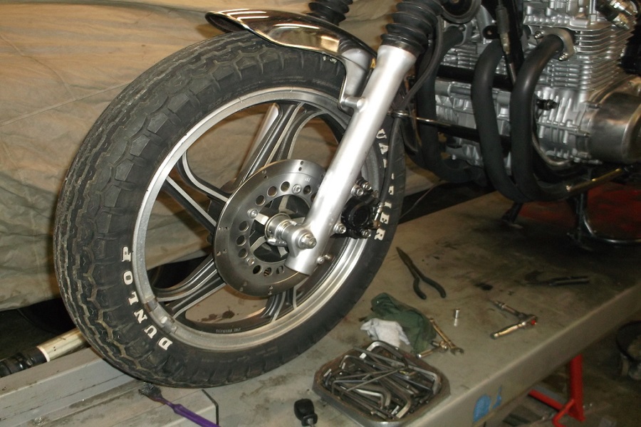

....The brakes ....... :dm: Yes...as you may have guessed.....Need alot of work.... and I'm not talkin about the thickness of the brake pads !
A year ago, I got a front end off of ebay for a 1100 LTD..... as listed.... as it turned out it was off of a
KAW "Spectre" same mounting specs,to the frame... but the brake caliper mounting specs were different, but as amazing as it may seem... the 650 caliper is a direct match.... but the rotor diameter is too great ! :hmm: .........So as you may have guessed, .... to the lathe she goes for a "nip and tuck"
These are things I don't normally do... but under the circumstances, I know this bike is going to a island, where the top speed is 35 mph. :gig: I can handle this beast :hpdc:

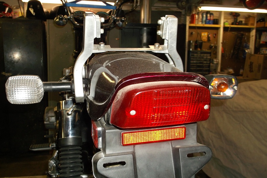

As you can see here ,I have the 650 handlebars and gauges on the 1100 LTD,and all lights and turn signals and break lights now working normally,
the seat was missing the day I got the bike ,and I even asked the guy I got the bike from ,if I could have a search thru the barn to locate it,cause he said that was the last place he saw it :Cball NO luck......but the 650 had a good seat on it that (of course )
did not come close to fitting a Zn 1100..... until I gutted it out and altered the structure of the seat pan
to make it conform to the 1100 frame ( :lol: keeping with the "spend no money"theme :lol: )then reassembled it and have a decent usable seat.
When my son Brad's buddy .dropped the 1100 ZRX into the forklift and did front end damage some time ago... the front turn signals from the ZRX are now facing backwards and have orange bulbs in them to replace the smashed stock 1100 ltd turn signals(again...spend no money)
So at this time... I think I have a ga=jillion hours of labor...and $600. bucks into this project, and as soon as the Toledo weather improves... I'm gonna take her down off of the air lift,and for the FIRST
ride she's been on... since that fatefull day ...30 years ago...................tony :-D
