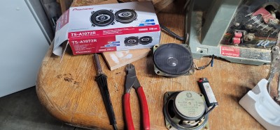

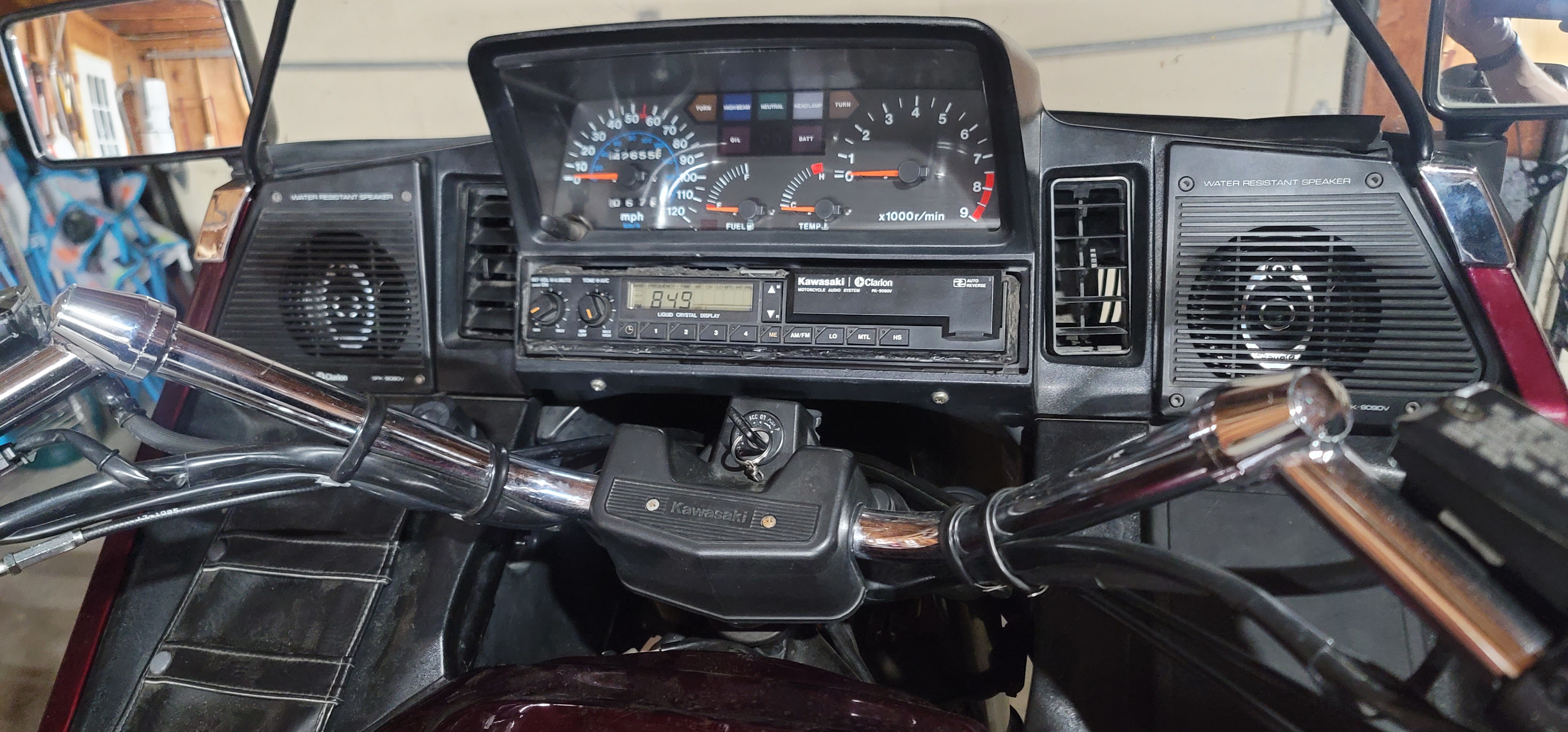

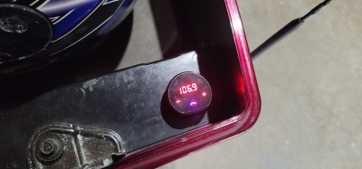

I put some new speakers in, put an antenna on it, and bought a Bluetooth fm transmitter. At first I mounted the transmitter up under the windshield but it didn't work well at all. I played around with various locations for it and found it works the best inside the rear trunk as close to the antenna as possible. Then with my phone in my pocket it picks up the Bluetooth music with no issues.
