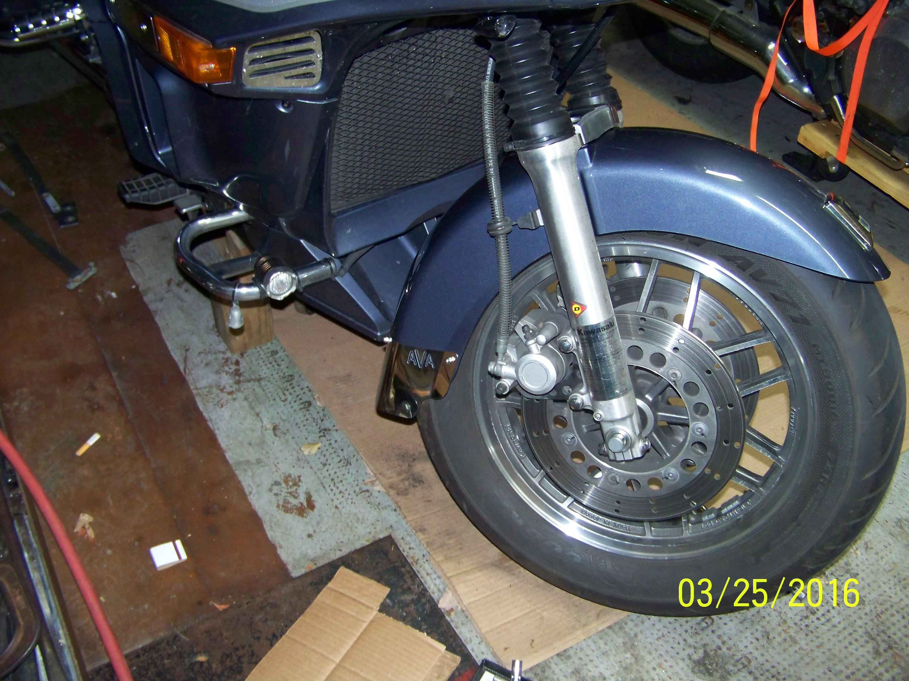

Started to get back into working on the bike this past week, and the front fender is on , with the second of my AVA fender skirts that I had made up. This took way too long but I had that issue last year with the sciatic nerve, which took darn near a year to heal up.
