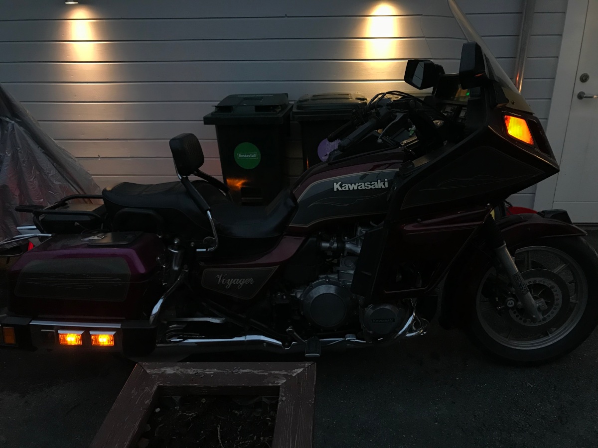

Thanks HMB Don. This was my first engine rebuild and I learned a lot. I didn’t change the crankshaft bushings, to do that it was also necessary to replace the connecting rod bolts. At this time I couldn’t find any parts. I didn’t want to spend the time with searching for the parts, maybe for months. I was impatient and decided to proceed with the rebuild.
The machine shop said that I should put in oversized piston to get the perfect piston clearance. Or I could just replace the piston rings. Maybe it will be okay for 10 years, depending on the driver style. I decided not to get the oversized pistons and rings. It comes down to how much money are you going to spend on that kind of bike? I will not have my Voyager forever. And the value is low. So I decided to let this be a learning process and try to get a nice everyday motorcycle. And I did :-)
Enjoy the bike season and drive safe

You made all the right choices, with the power that 1300 has you'll never net to rev it into the big numbers. Most of the time on my 1200 i can stay below 3,500 rpm and have lots of fun.
