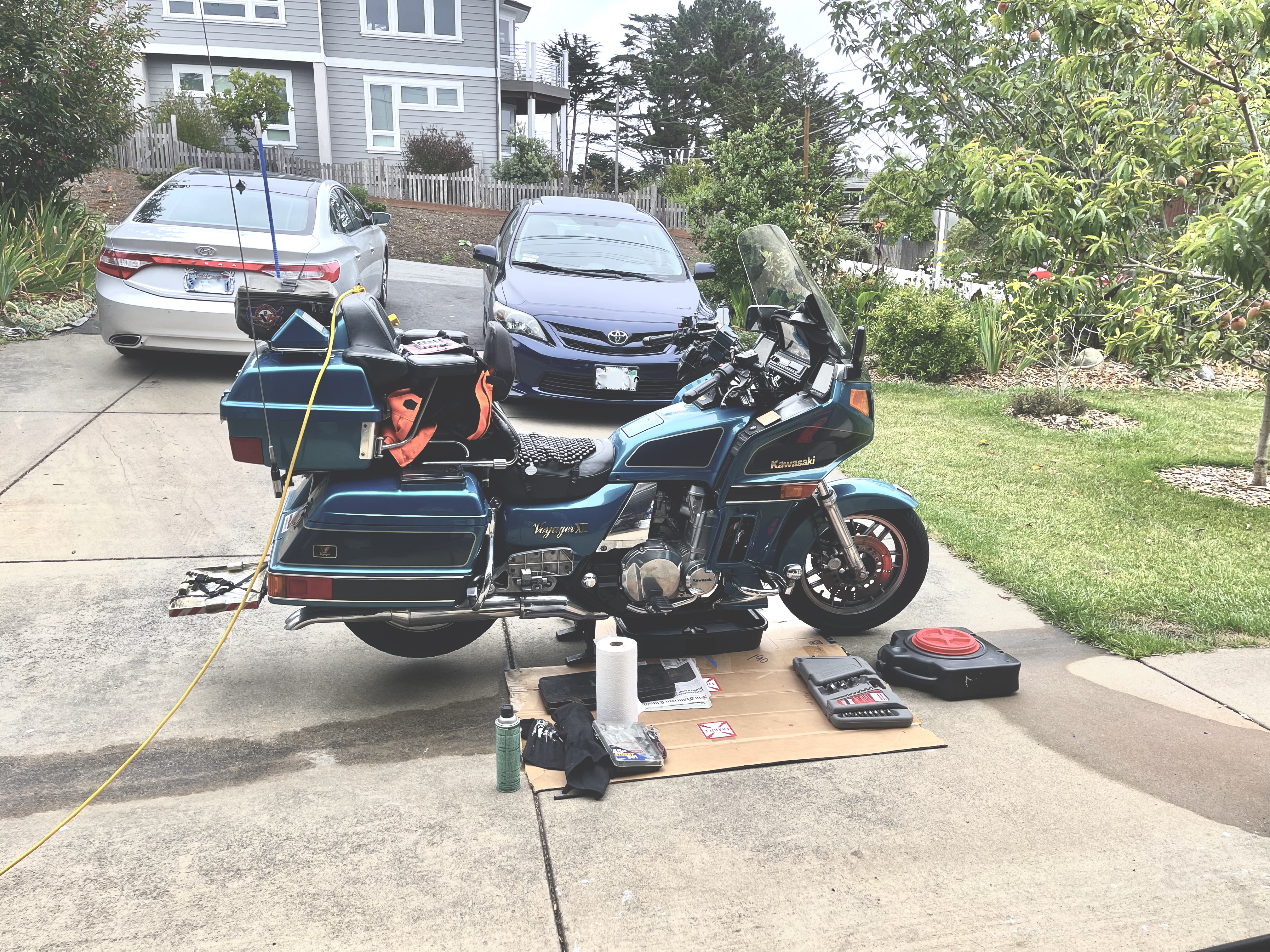

Well, I survived Covid 19 last year, and it hard to believe that a whole year has gone since posting about my gear balancer seal leak.
I sure do appreciate all the terrific info from my friends at AVA, and NorCal Voyagers too. I finally took my ride out of the garage this Saturday, and am ready to roll again; maybe into Az in 2022.
The bike fired right up after sitting on the tender for a year, and adding fuel stabilizer back then, but; and it had two back fires, and hoping I didn't blow a hole in a piston head. I've seen some piston heads, and they are pretty beefy, so I'm not too worried about that so much as that the bike is coming up on 30 years or age.
Well, I found I did a silly thing after completing the repair this Saturday, then checked for leak/s in the evening, and there was one drop on the banjo: I put both copper gaskets on the head of the banjo bolt, when I loosened the bolt to loosen up the oil pipe. Of course I had to notice that after I put the fluid in. Well, I don't think that's going to be too difficult for me to correct. I ordered some copper gaskets, arriving on Monday, so next time I drain the oil, which could be this week again, I'll go ahead and change out all of those banjo and oil plug copper sealing gaskets /washers while I'm at it.
HMB Don was spot on as usual: It took no time at all to coax the old seal out. I would have liked it better if the seal was marked for direction, so I looked at the seal opposite, and Kawi has the flat side facing in and the ribbed facing out. I haven't started up the bike, so there's no pressure built up in the motor, so I'm going to challenge myself to get that bolt and washer off in lighting speed and minimize the oil gushing out.
Next, I need to get my chrome done, because this ocean living is tough on metal, but everything else is holding up mechanically that I can tell. Plus, I discovered Fluid Film, and I think this product may add years to all the metal around our home and on the bike and autos too.
In any event, our Summer is just kicking in here on the coast, but once again the air has been filled with smoke from all the wildfires happening here on the west coast in 4 or more states. Maybe I'll be able to make it to AZ for the Rally in 2022- from the fire to the frying pan :0) though I can see the 27 years, I've had this machine, beginning to show its age - like its owner.
Hoping all is Well, and You are having a terrific summer on your machines and otherwise. Thanks for finding my post and responding in kind.
Update: 08/04/2021:
The oil pipe banjo repair is completed and is staying dry to the bone; and so is the new gear balancer seal: It was a piece of cake. I even got to torking the lower end while I was down down there. It honestly sounds like its purring, I think the bike likes the Shell Rotella a lot - Thank you Carl Leo. :0) I've been running Castrol RS racing full synthetic 10-40 for the past 10 years or more, and really like the way the gear box responds with it too. I still have enough Castrol for another oil change if the Rotella feels wonky. I'll make time to run through the gear box this weekend, and compare oils, since I'm new to this Shell Rotella conventional. I think this conventional oil might be kinder to the internal workings and seals too.
The balancer seal seated itself so easily, I was concerned that oil would push out, but it doesn't. I'm so happy, and will get the cycle out for a joy ride after my Odyssey PC680 gets here on Thursday.
