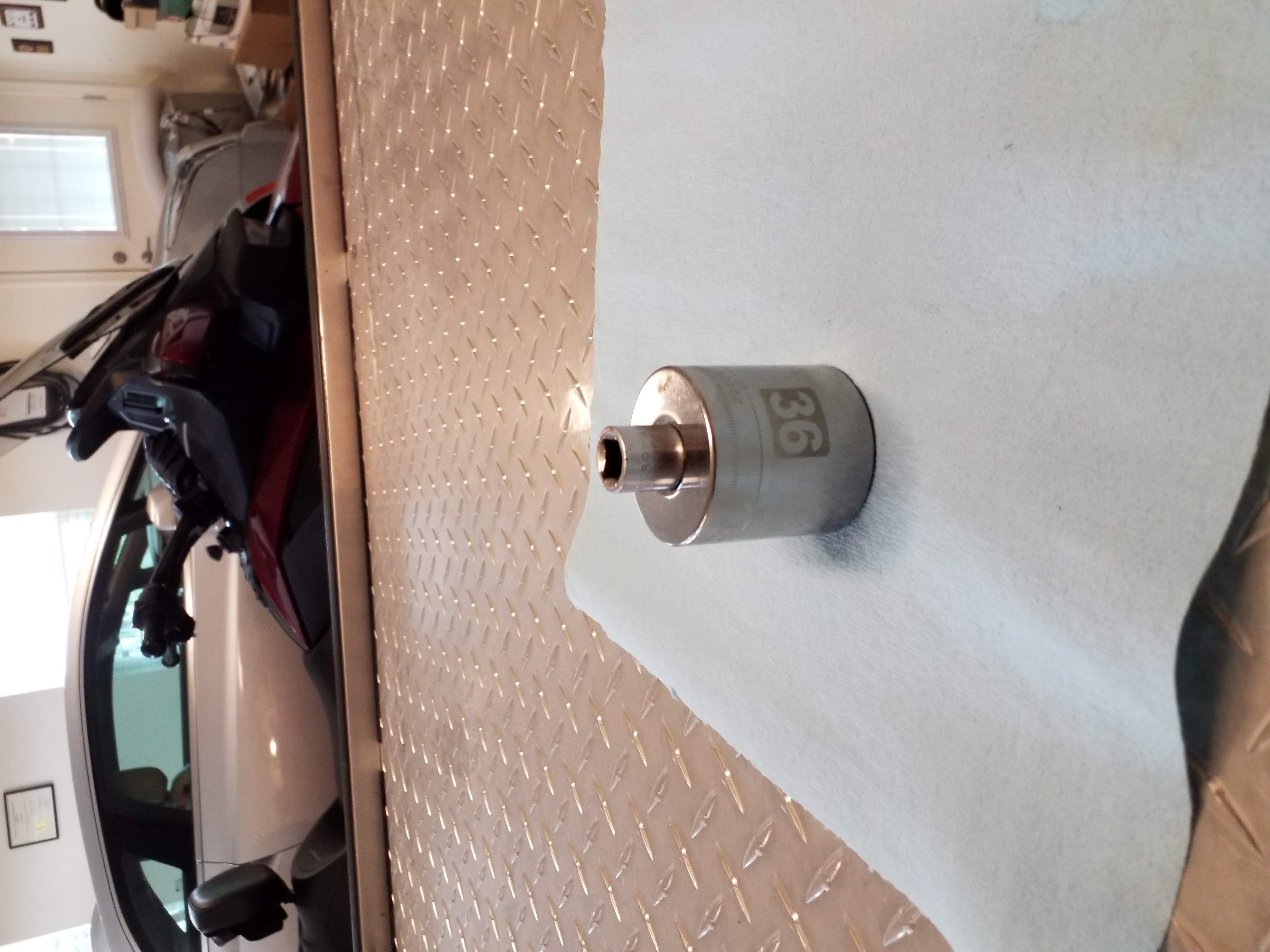

Appreciate any recommendations ... breaking down to adjust the front steering stem bearing and having a heck of a time finding a compatible socket for the Steering Stem Head Nut. "Periodic Maintenance 2-39 in manual. Removing the nut will allow removal of the Steering Stem Head.
I believe it is a 38MM nut but most sockets are too thick to get around the nut.
Is there such a thing as a thin walled 38 mm socket??

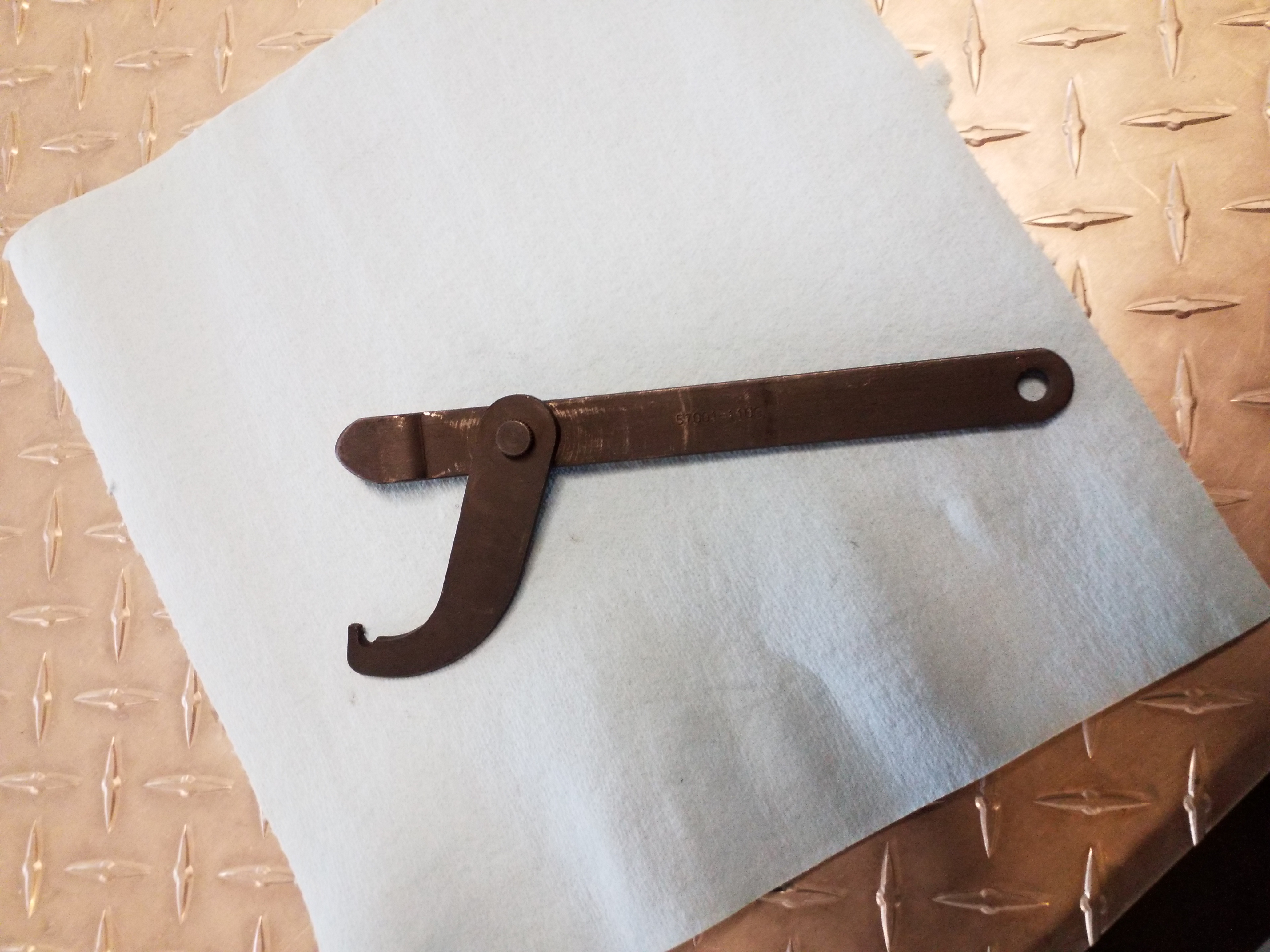

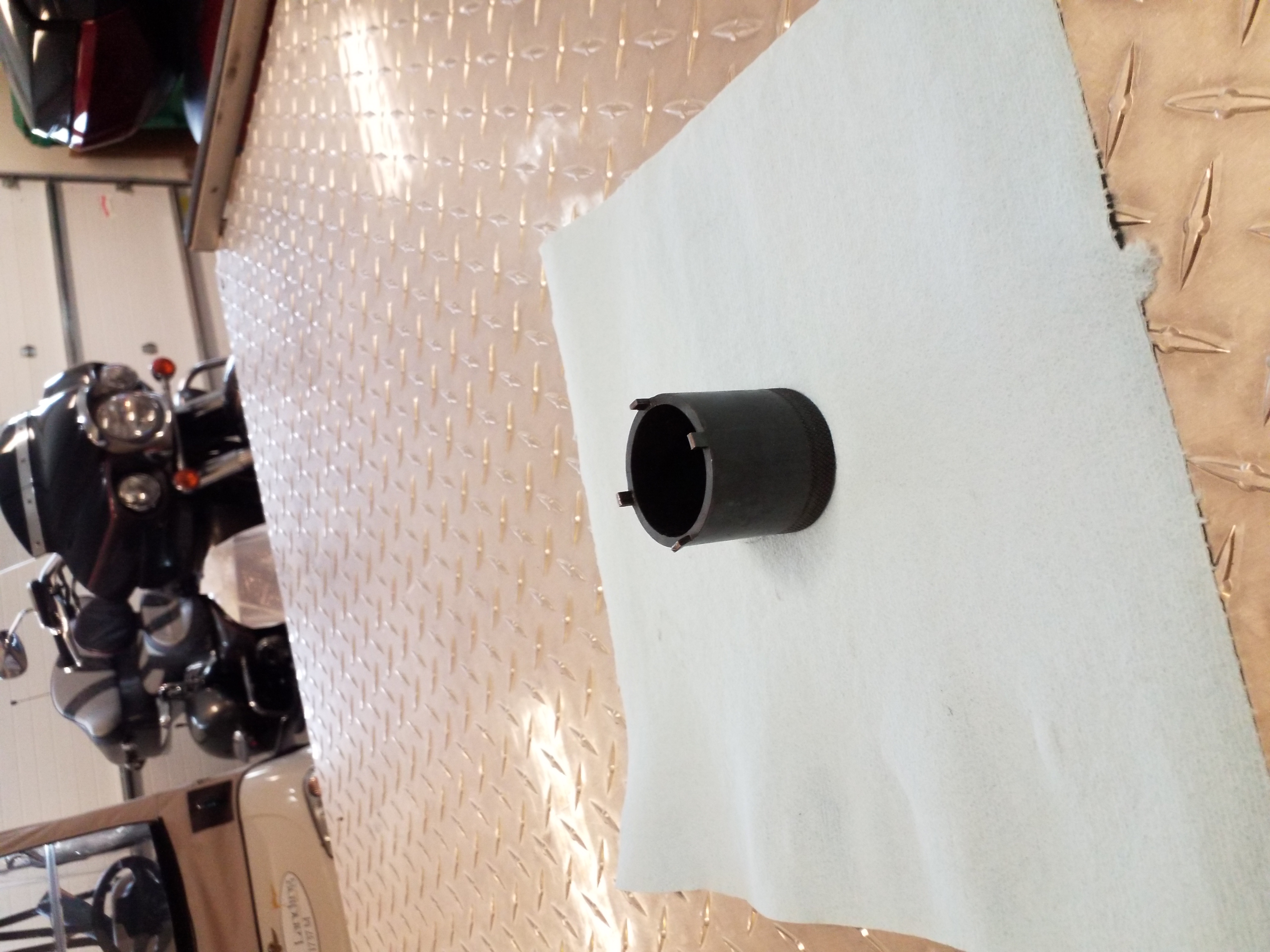

- Posts: 758
Re: Steering bearing servicing with pics
The socket for my 2012 Voyager is 36mm Craftsman. I'm attaching three pictures of the tools I use to adjust the preload on the steering stem. But while your that far into the steering grease the bearings.
After you remove the upper triple clamp you'll see a castle nut (this is the nut you adjust to take the free play out of the steering head.) Lift the front of the motorcycle enough to expose the lower steering head bearing to apply grease. Then lower the motorcycle back down and reinstall the upper bearing and cap. Start torquing the bearings, slowly. Work the handlebars bach and forth many, many times. Then torque again. Keep doing this until you take all of the free play out of the bearings.
