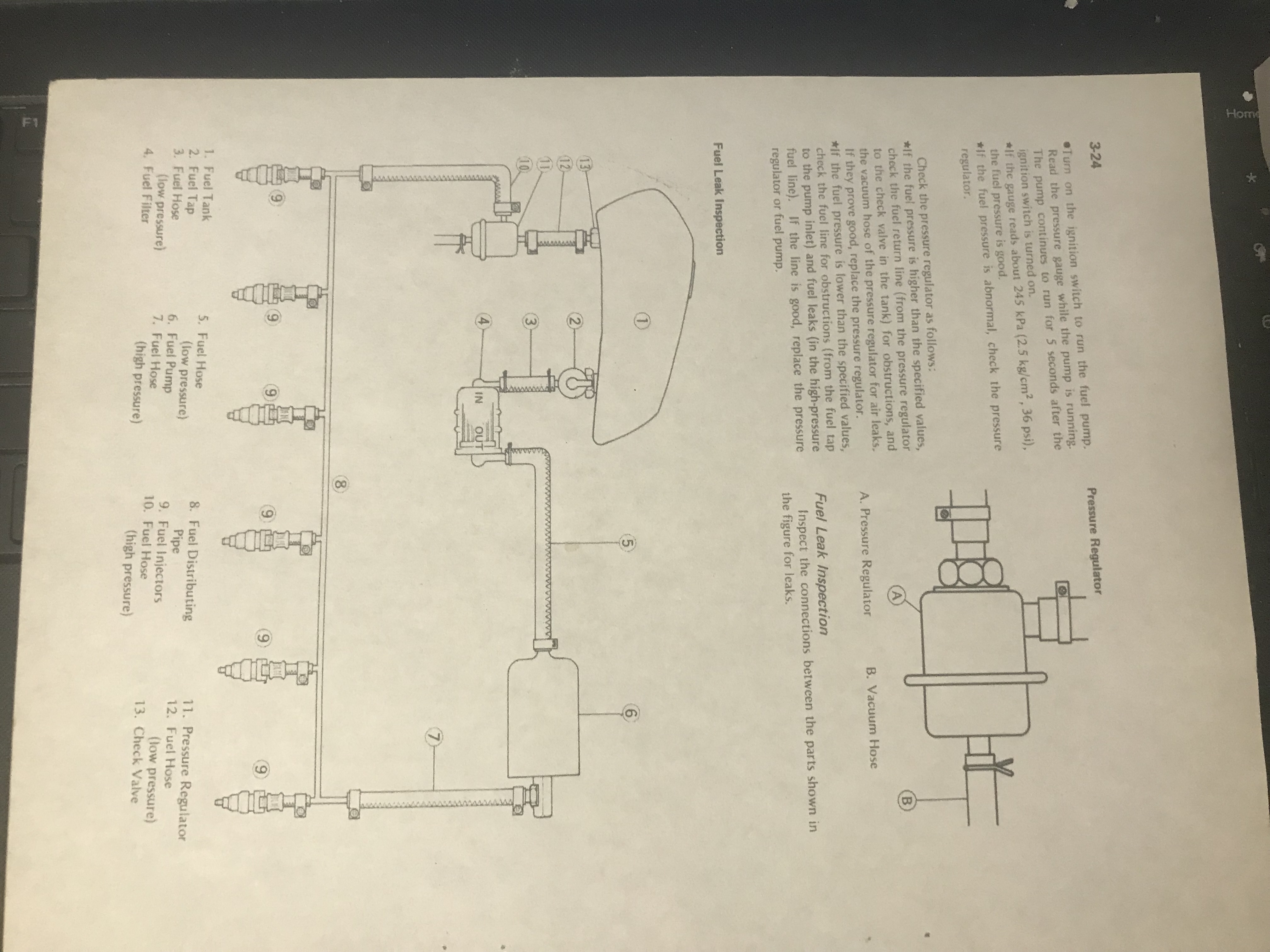

84 voyager. I removed the tank. Here is what i found.back left corner of rank a fuel line from somewhere about 5/16 fits over that.petcock has a couple of large diameter hoses clamped on.one disappears somewhere i guess hooked to a throttle body.so there are 3 throttle bodies and each one has a separate line from it to the tank? One large line,about 1/2 inch diameter goes from petcock T underand across frame toward right side of bike and it had a fuel filter hanging in the breeze.so goes to nowhere, from petcock to nowhere.seems like it should be to a throttle body somewher.last question when i turn throttle grip the cable goes to a place like a throttle body and i see the mechanism turning.so is that the only cable to throttle body connection? The rubber line to nowhere makes no sense

Re: Where do hoses go
Hope this is readablegrumpy72 wrote: ↑Wed Apr 27, 2022 9:37 am 84 voyager. I removed the tank. Here is what i found.back left corner of rank a fuel line from somewhere about 5/16 fits over that.petcock has a couple of large diameter hoses clamped on.one disappears somewhere i guess hooked to a throttle body.so there are 3 throttle bodies and each one has a separate line from it to the tank? One large line,about 1/2 inch diameter goes from petcock T underand across frame toward right side of bike and it had a fuel filter hanging in the breeze.so goes to nowhere, from petcock to nowhere.seems like it should be to a throttle body somewher.last question when i turn throttle grip the cable goes to a place like a throttle body and i see the mechanism turning.so is that the only cable to throttle body connection? The rubber line to nowhere makes no sense
I appreciate the effort but it isnt readable.where can i find this and i will look at it myself,maybe turn it straight and enlarge it
Unfortunately that is from the manual you could not download .
I had removed the inline filter while investigating.on one end the word OUT is there. Does that end go to the line going to throttle bodies or does OUT GO on the top pointing upward to the fuel petcock.called fuel tap here by some people posting.
The line goes from the petcock (fuel tap) to the filter. From the filter to the pump (that line has different size inlet/outlet)/
From the pump to the injector pipe (distributing tube). From the tube too the pressure regulator, from the regulator to the check valve at the rear of the tank.
