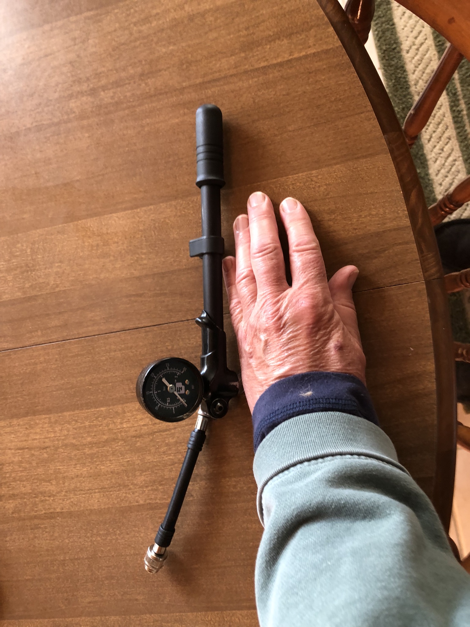

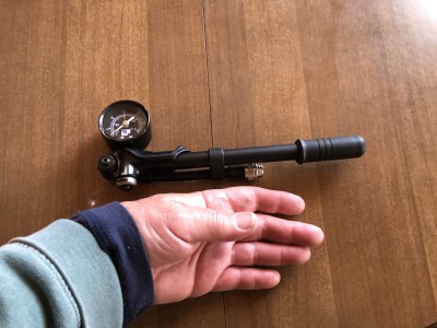

krasmu
Posts: 405
Joined: Thu Sep 24, 2015 10:00 am
9
Been liked: 18 times
Re: Adjustment of shock air pressure
Post by krasmu »
I use the same small volume air pump with gauge shown earlier. Picked it up at my local Harley dealer. Works great. I've been running 8 in front and 40 in rear with dampers set at 4. works great alone but bottom out on bigger bumps with 2 up. After reading these replies, I'll be pushing the rears up another 10 psi next time my wife tags along.
