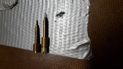

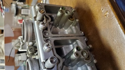

Incidentally, all the plugs were in mine (don't know if original or not). Carbs #1 and 2 the pilot jets were roughly two turns out. But carb #3 was bottomed out completely and #4 was only 1/4 turn from bottom. Weird.
Anyway, my current conundrum is that the replacement pilot jets are longer than the originals by quite a bit. When installed and given the two turns out, the top comes out higher than the boss.
Is this going to be a problem or should I just clean and replace with original jets?

I'm going to use them. The tips are the same, the replacements are just longer on the back end.
