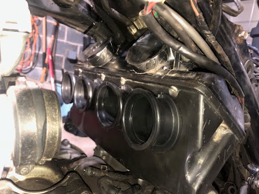

The new lower airbox (aka known as the "surge tank") and new boots (aka "carburetor holders") in place awaiting carb placement:

Latest update: the boots are, according to my buddy doing the work, a pain in the kronk. He says that's been the only difficult part of this whole adventure. He says these machines are easy to work on. That's compared to Concours 1000s and 1400s.

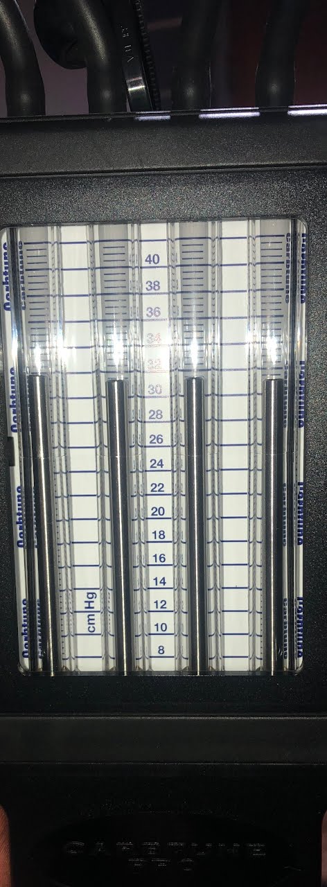

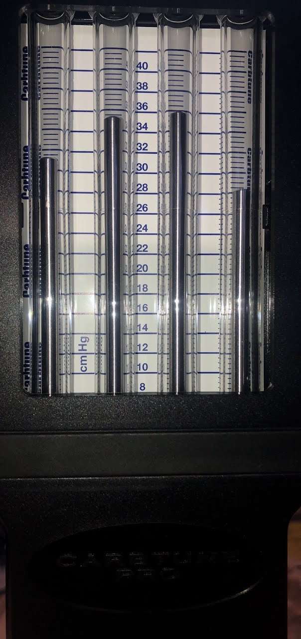

Carbs are in. Bike is running. initial vacuum readings before carb sync::
After synchronization:
