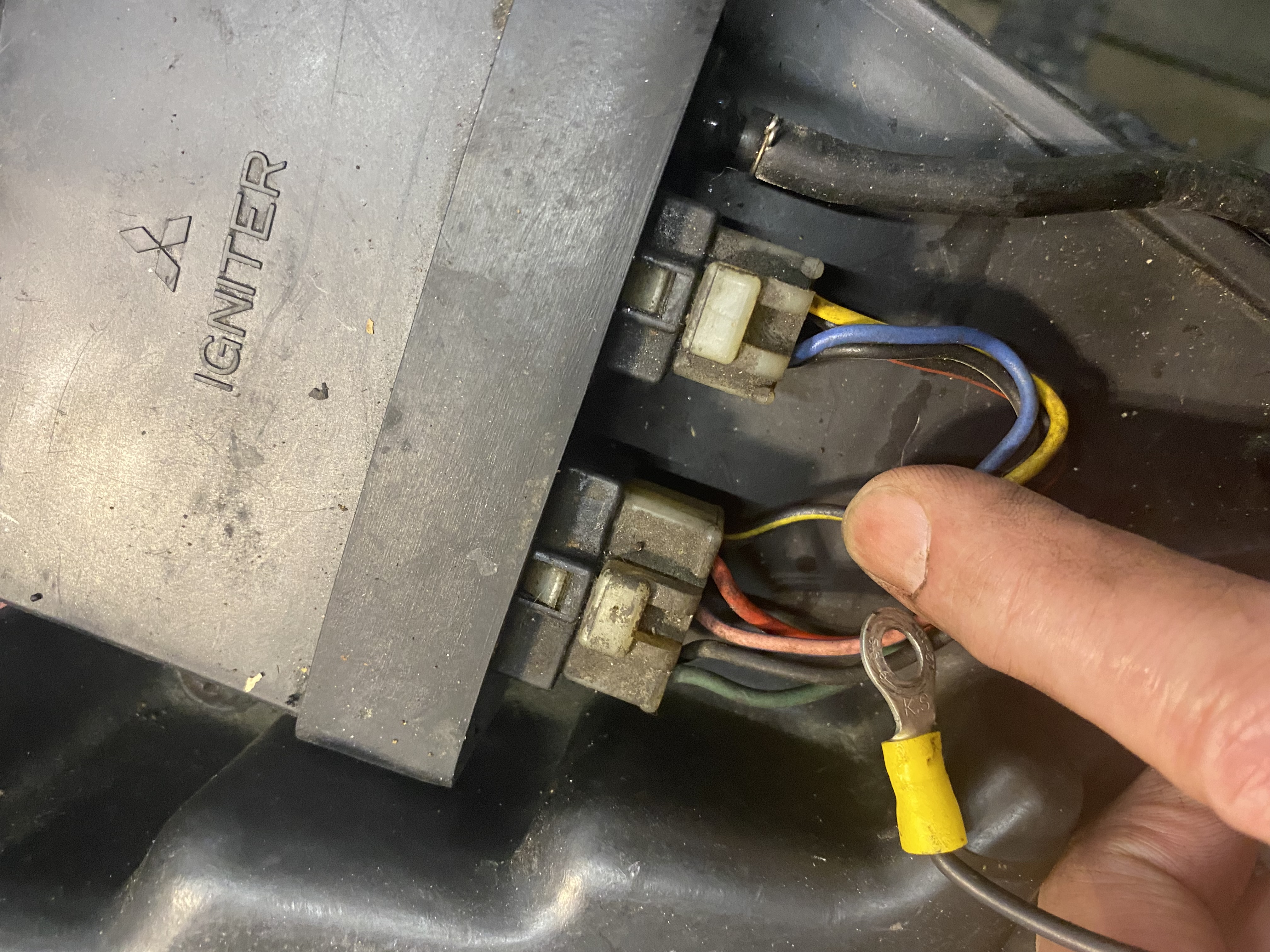

Re: No spark on my 92
Make sure you have a ground to your igniter box. Mine has a dedicated ground right to the battery, I sometimes forget to attach it when putting the battery back in, it was a suggested alteration on this forum years ago. I’ll take a pic later so you see which wire going to the igniter is the ground
Thank you all for the replies.....it's alive again. I did forget to reinstall a ground wire, but the leads on kick stand were pretty gross as well. Not sure which woke up the beast, but at this point it doesn't matter, it's running! Thanks for the replies folks!
