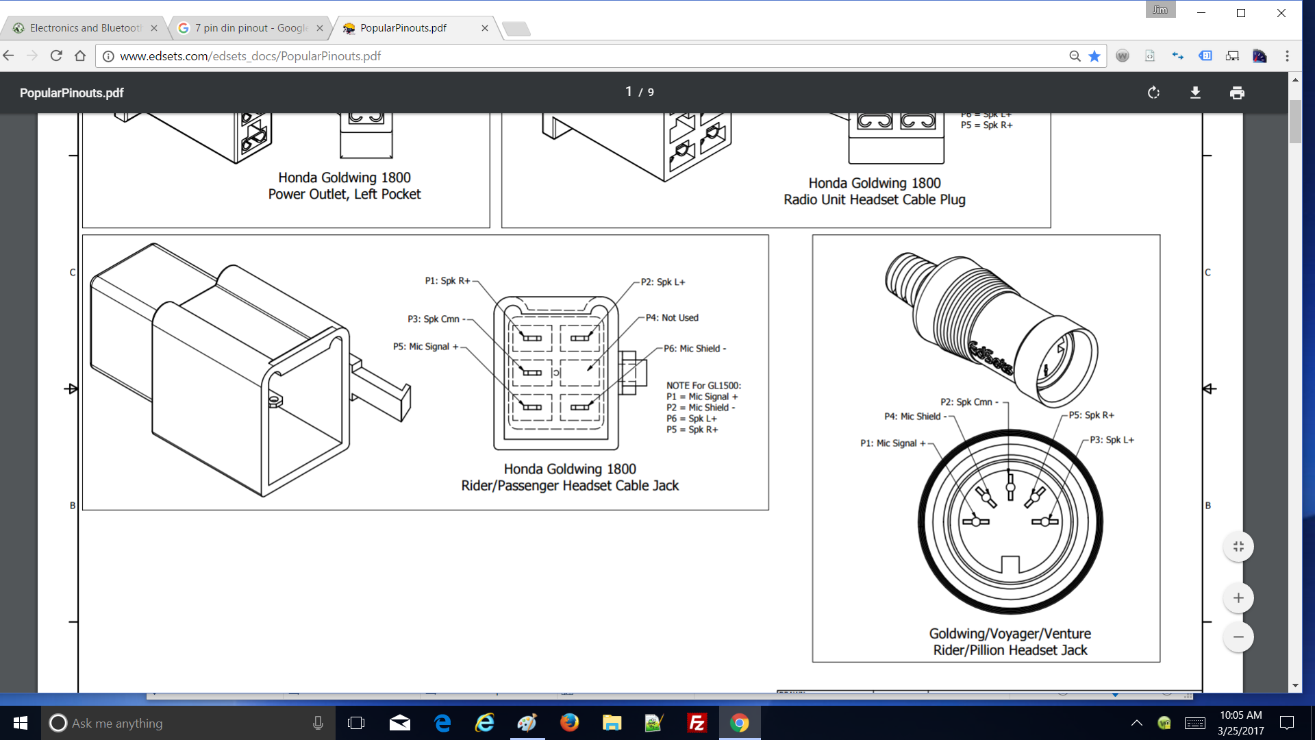

OK. I found that the Sena Freewire is available with the Harley 7-wire plug OR the Goldwing 5-wire plug. The real question here is Are the 5-wire plug pin-outs the same on the Goldwing as the 1700 Voyager? Anyone? ... Anyone? ... Bueler?
If they are a match, we are golden.

Yes the 5 pin din, pin out is the same for the 1700 as the Gold Wing

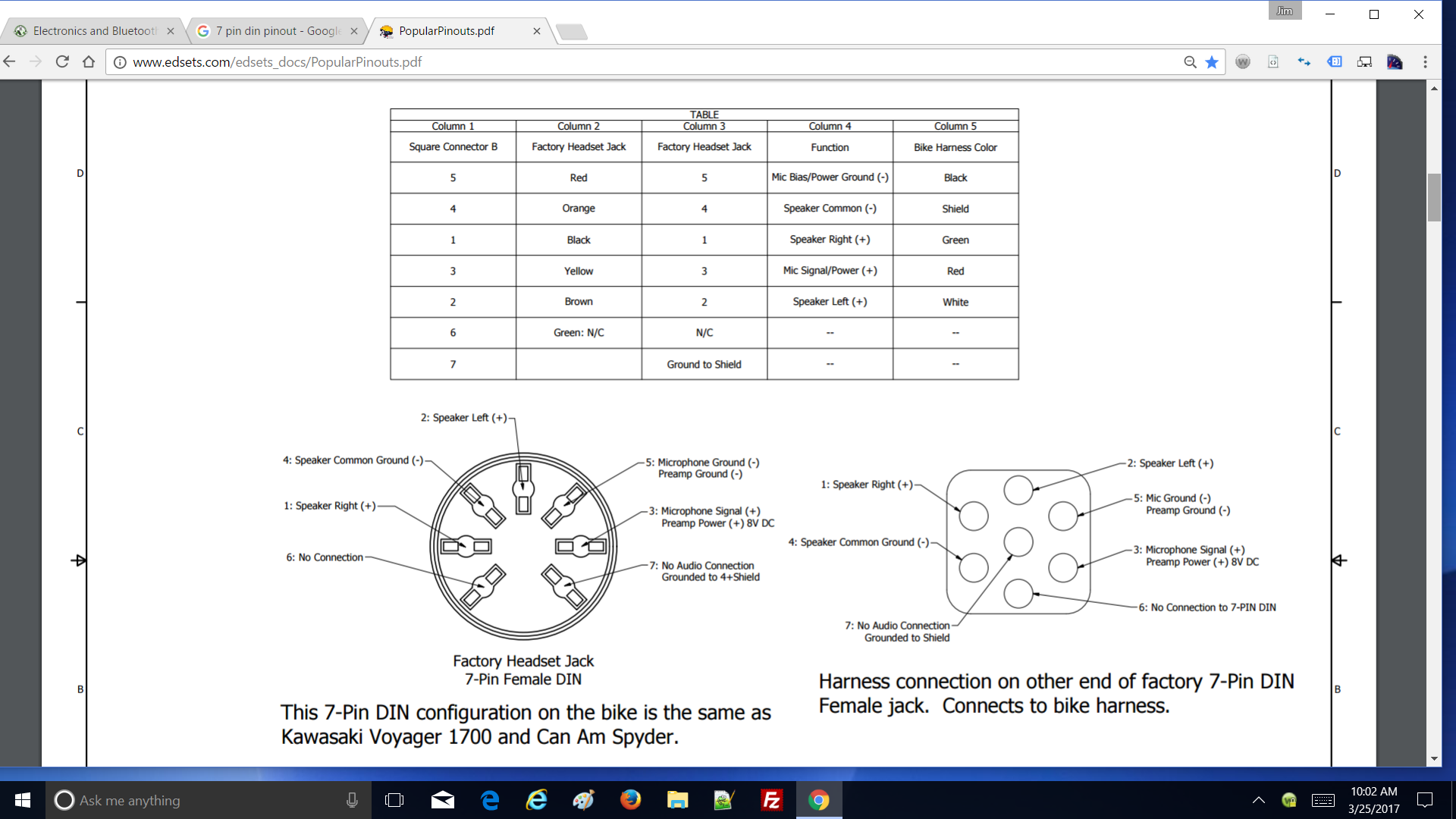

OK, so now I'm confused. I got responses from Hank43 and Highway Rider that indicate that the 1700 is a 5-pin system. Neal indicates it is a 7-pin. I think they are both right! Looking at the schematics, Chapter 16, Page 108(16-108), Item-14, I see that the rider pin-out is 5-pin and the passenger pin-out Item-5, is 7-pin. Obviously I want to be able to hear/talk to ALL the devices (including Deb ... GRIN) and she wants to be able to at lease hear/talk to me. A local Kawasaki/Honda/Can-Am dealer says they want to "do" a Voyager and will work with me. (I hear $$$) Has anyone actually done this? :?: What about the VOX function?

With in a 5 pin system there are 2 pins for the mike and then 1 pin is a common for the speakers and the 1 pin for left speaker and 1 pin for right speacker

As you can see the 7 pin is wired differently then the 5 pin. But the 6th pin is not used and the 7th pin is a connection to the wire shielding which is grounded and that is to help combat interference I believe.

Thanks to Hank I have a Kawasaki CB mounted on my 1700. Both connectors are five pin which is the same as the gold wing. I know because sometimes I plug into the passenger plug.
