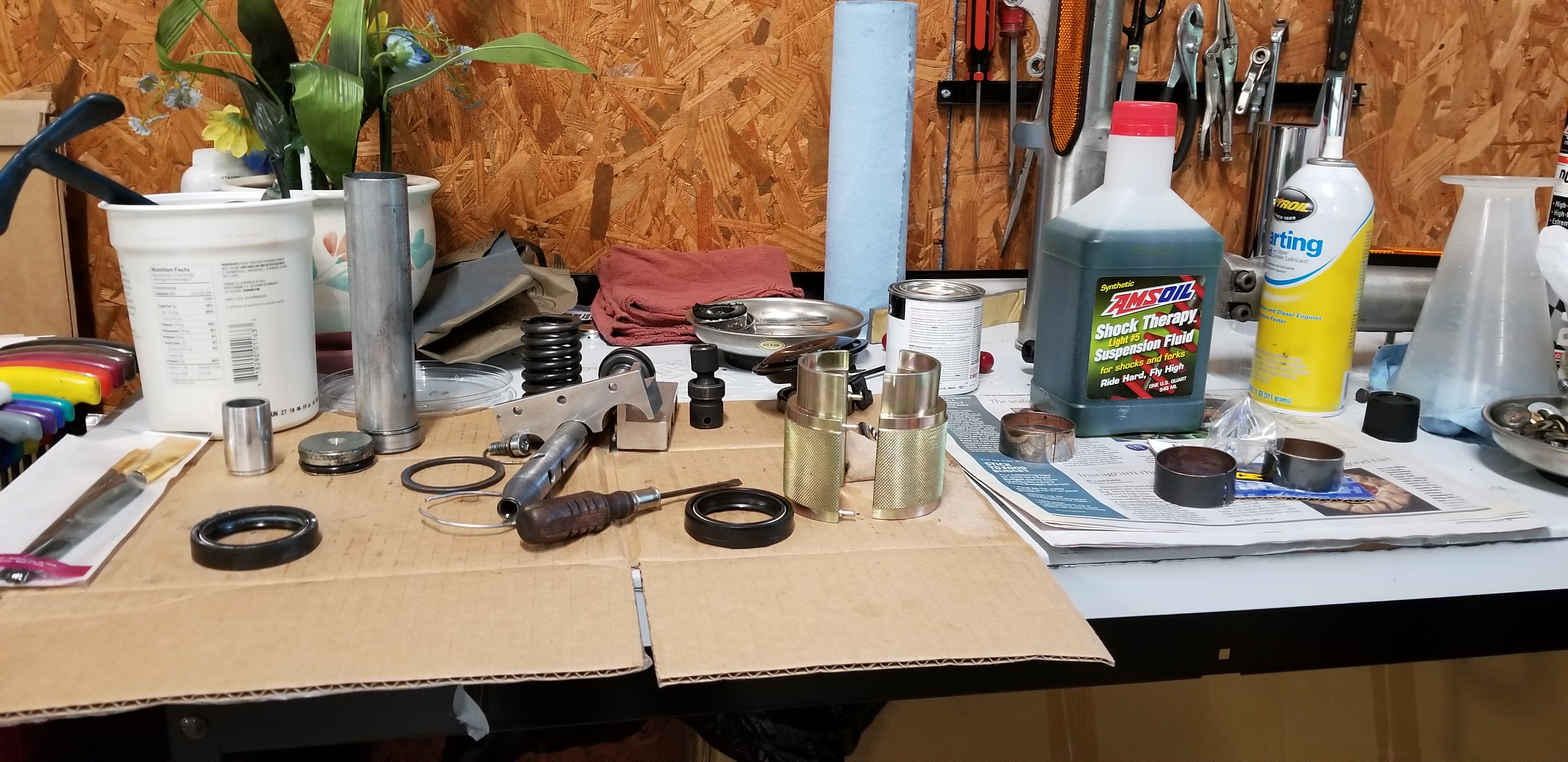

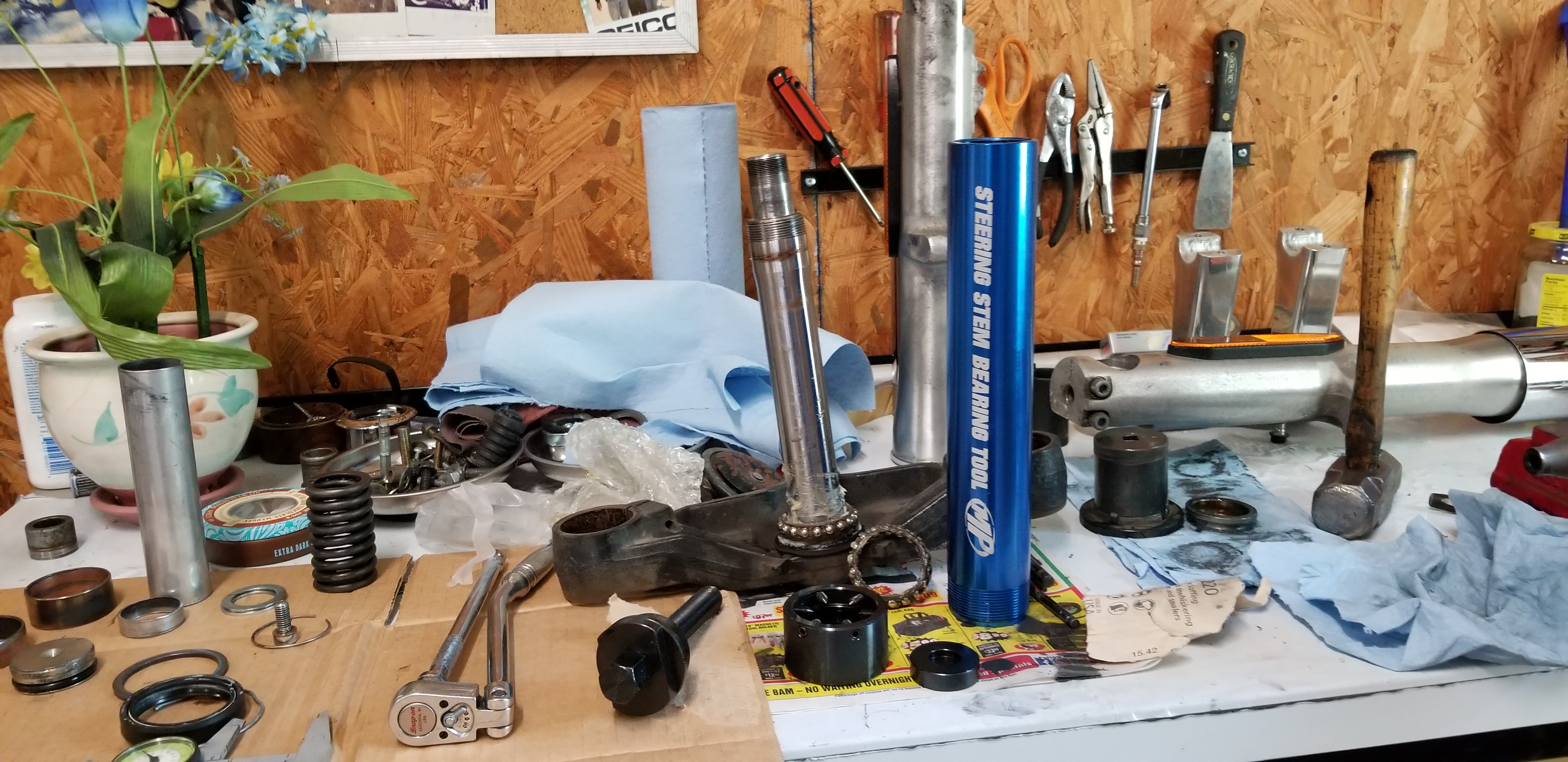

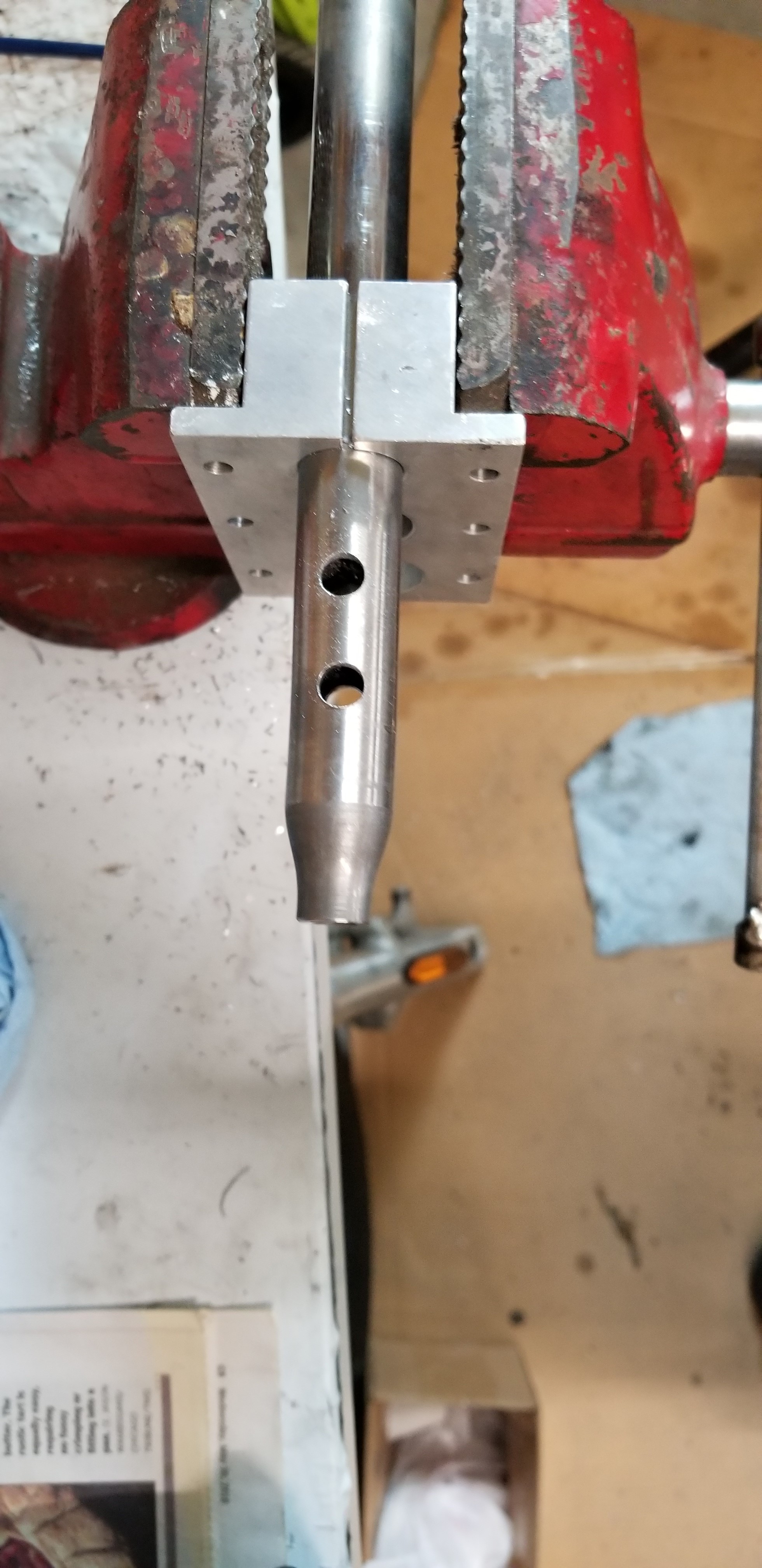

Well just finished replacing the caged ball bearings to caged roller bearing in the steering head. Wow what a difference, my Voyager1700 steering like cutting through hot butter. Next was installing the Race Tech gold valves in the front forks. After drilling a four extra holes in the dampening rods and enlarging the two holes that where already there.
Today I took the Voyager out for a test ride and the front end just ate the bumps and anything that makes the road rough. It was a joy to ride, made want to keep riding. But that'll be next week on the way to the Rally

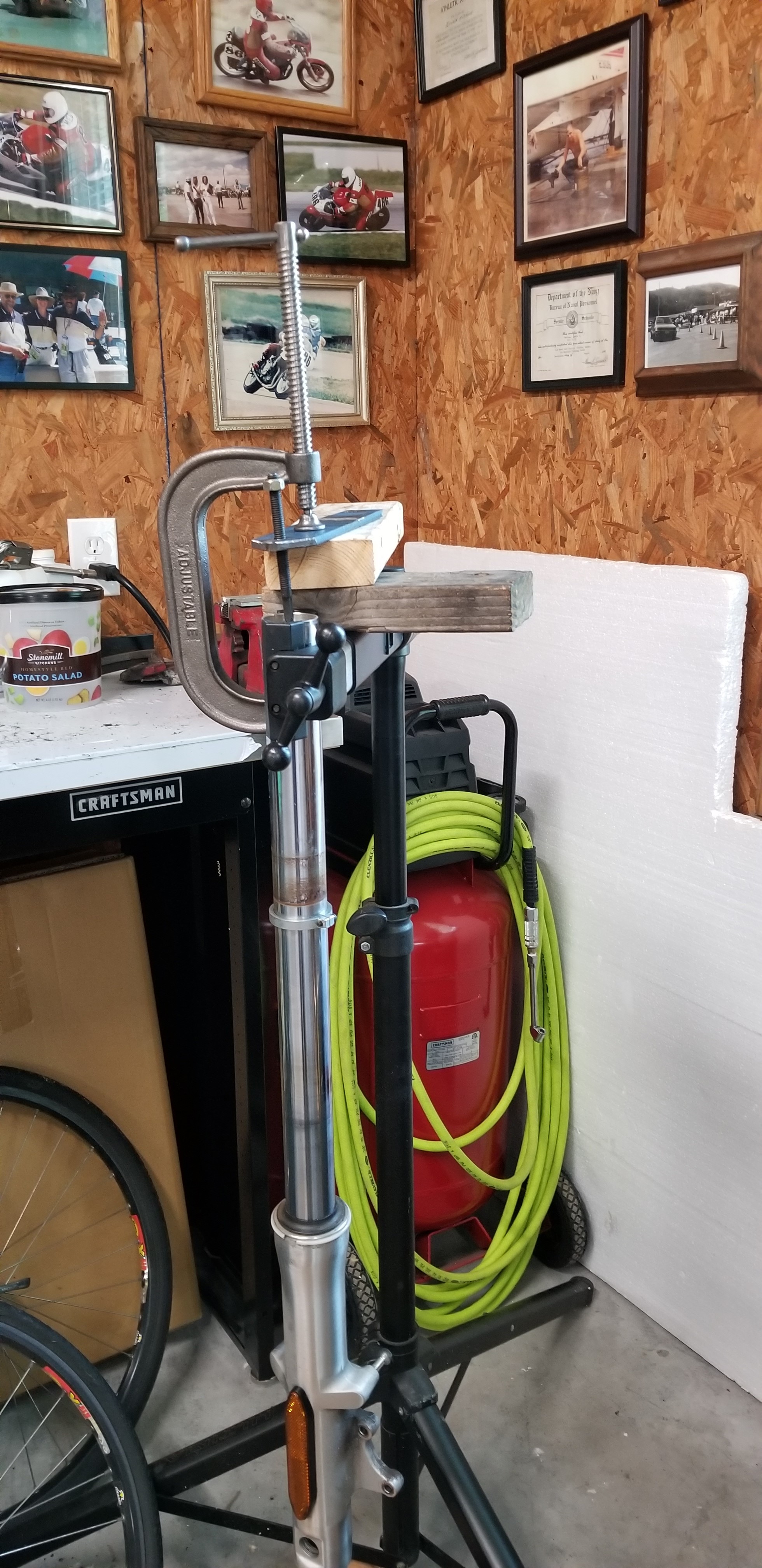

You're an animal! How did you bend that ratchet handle in picture #4?

Yes that is a funny animal, bent like that but really works in some areas. In this picture #4 looking at the steering stem, all of the grease is Amsoil grease. These bearings were packed at 54,000 miles and this picture was taken when the motorcycle had 141,000 miles. That grease on the stem and bearings has been in temps between 35 and 114 degrees. The stem nut torque was 22 ft pounds on the 1700 vs 95 inch pounds on the 1200. Ball bearing vs roller bearing. That is why those 1200 Voyagers don't die, they came from the factory with the best components. Getting my 1700 upgraded.
I want to thank Gert for those syringes I was able to add a hose to one and make an fork oil gauge and suction valve out of one. Which I used to help me set the fork oil height in each fork. These worked much better than a Turkey baster.
