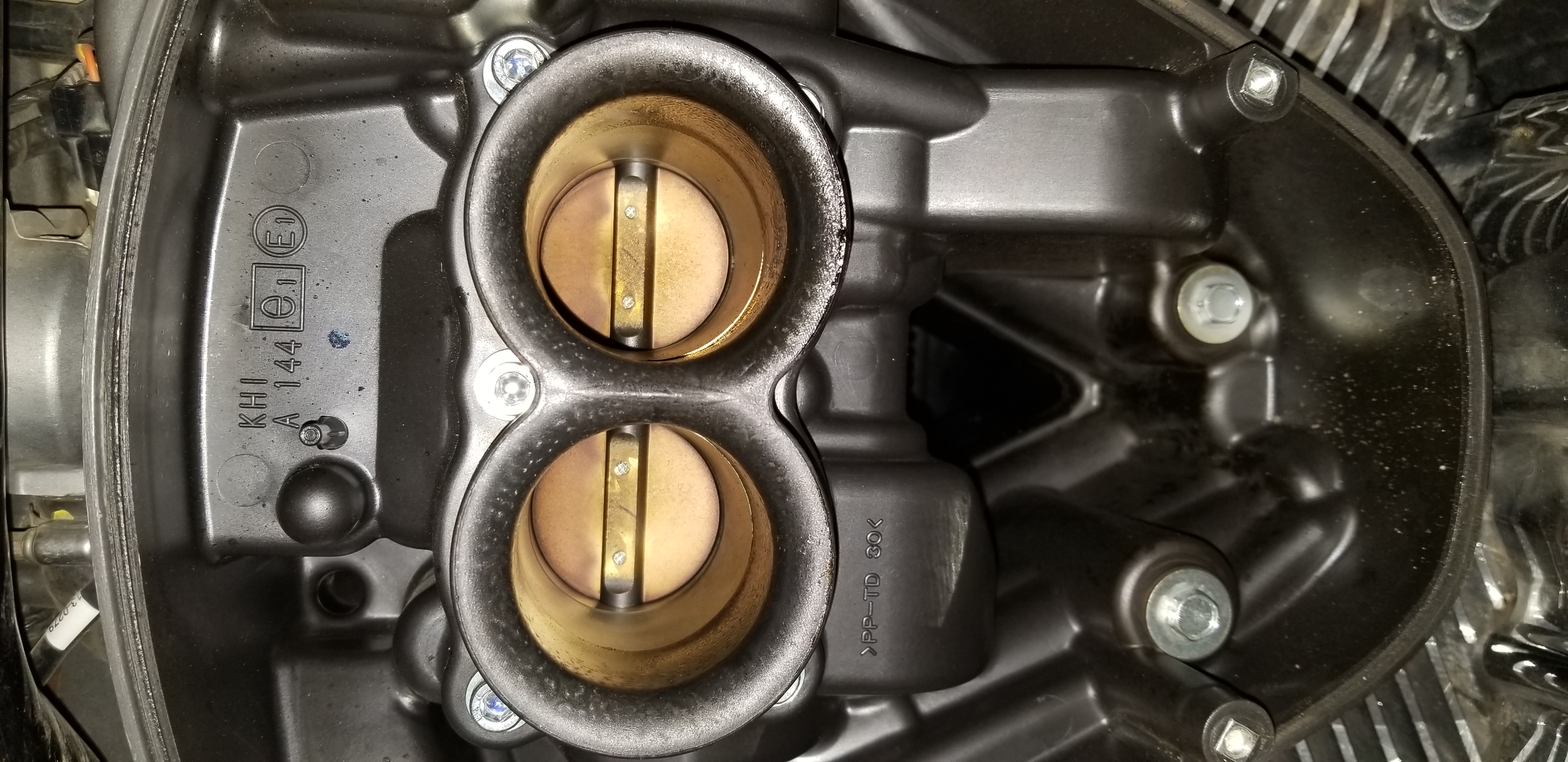

F1 error message
Post by mackbond+1950 »
I have a 2011 1700 voyager on several occasions I have gotten an E18 or 8 F1 error message and bike loses most of its power but if I let it set a few minutes it clears up and the error message goes away. Has anyone else had this problem and if so what did you have to do to fix it. It does not happen all the time but becoming more often

Try cleaning your throttle body. I use chem tool b12? fuel injector cleaner on mine. I spray a small amount into each bore, let set a couple minutes, then turn on ignition without starting. This allows the throttle blades to open when you twist the throttle. Wrap a clean rag around the end of a flat tip screwdriver and soak the tip of the rag in cleaner and wipe the bores where the throttle plates contact the bore when closed. The rag should be black from the carbon buildup you are cleaning away. Do this a couple times until the rag is still clean after wiping the bore. I have noticed mine will get a bit of hesitation to it at low, just off idle speeds before the code starts showing. This clears this up as well. Once the rag is clean after wiping, start bike, may be slow starting the first time. Hold throttle to around 2-3000 rpm and give a quick spray into each bore. it will stall if you spray too long. Do this 4-5 times into each bore and you are done.

.... used 6" Q tips and Seafoam on my 01 Nad.... got 100 sent to my house for < 5 bucks,
great for the job! JM2C
