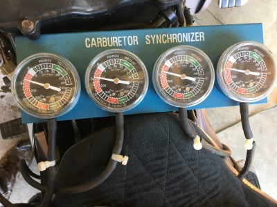

Ok so update time. Put new plugs in checked sync again its still perfect rode today about 60 miles above 2250 rpm its smooth as can be. Below that its kinda jerky. While riding id come to stop had to turn idle down 3 separate times. Ordered new carb kits going to try put new pilot screws in with o rings see if that does anything. Any other suggestions ? Its about to get sold if can’t figure this out. Now i have oil leak at water pump to
