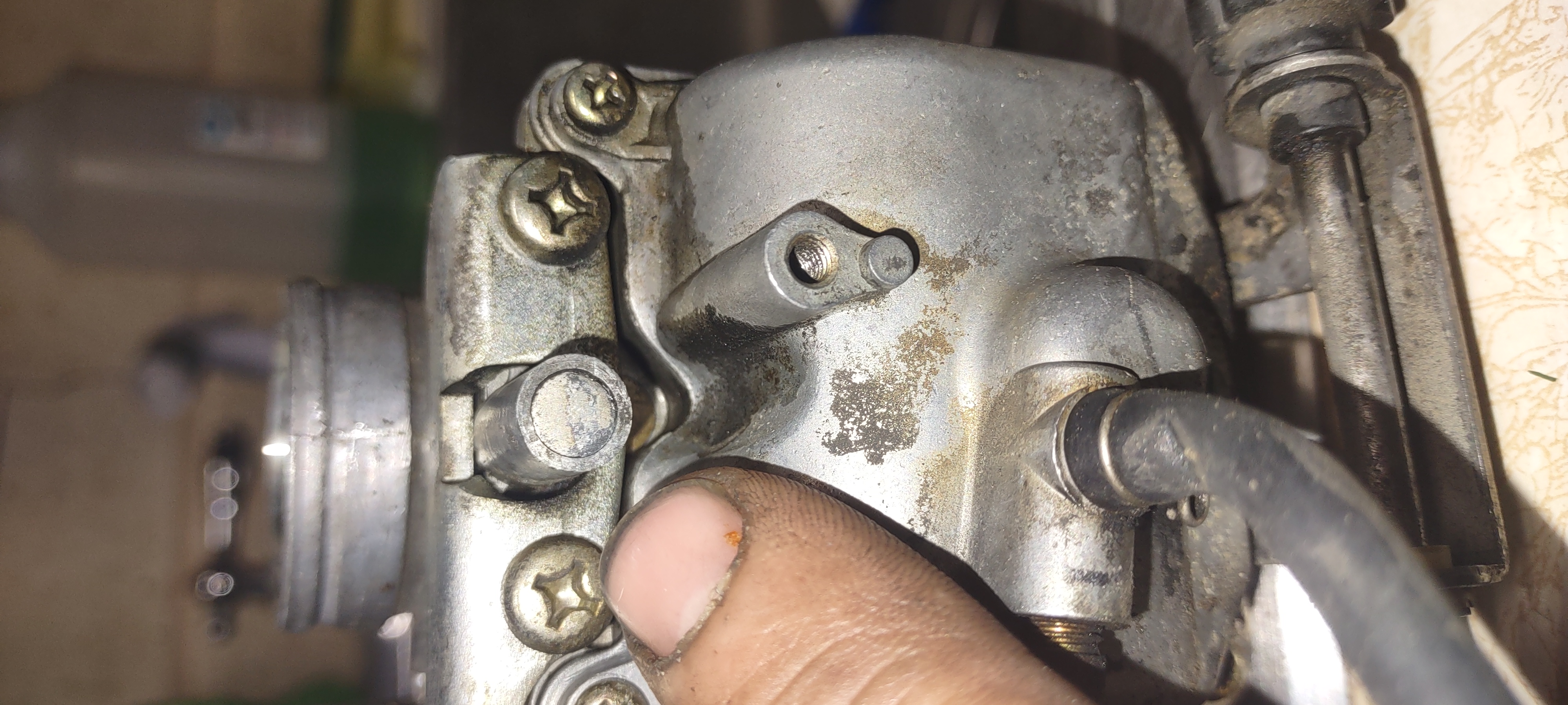

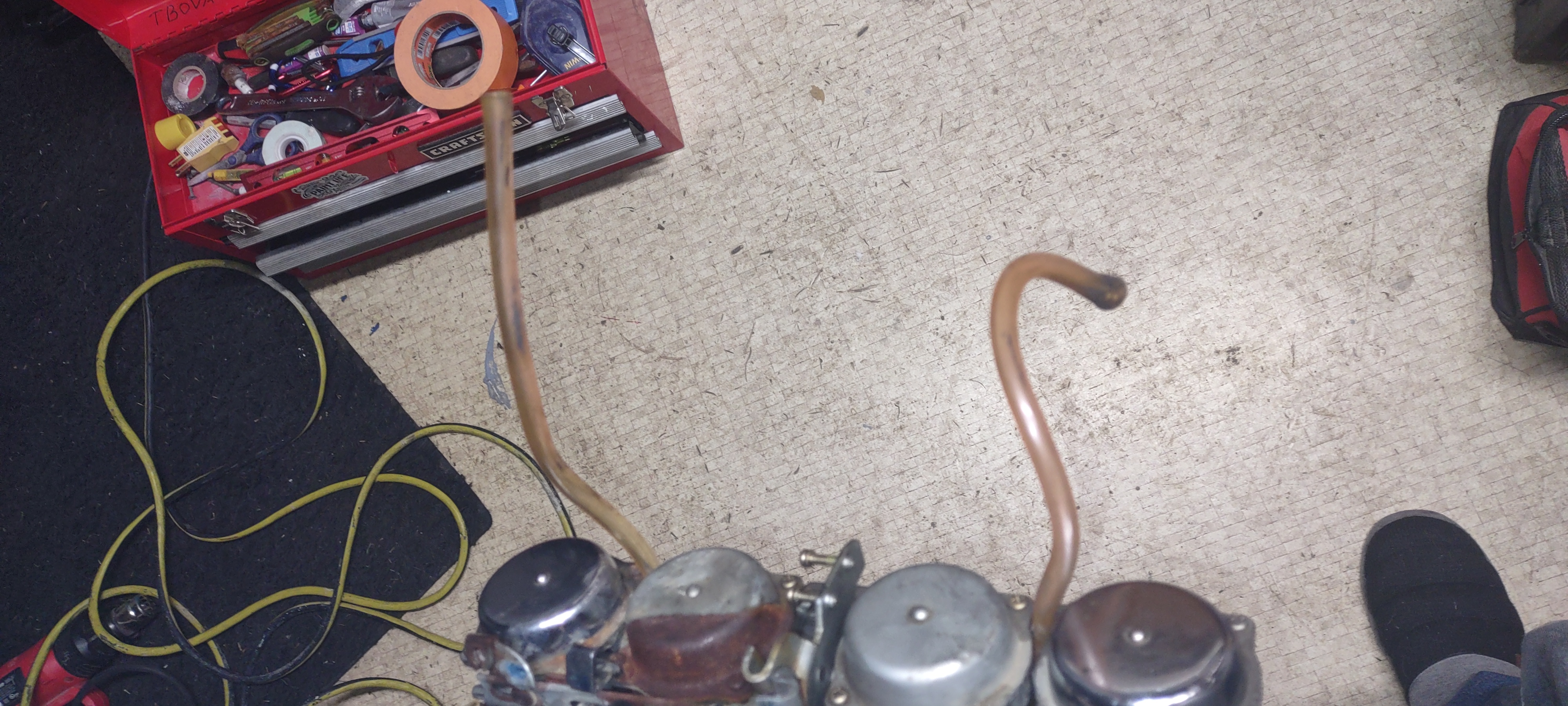

As I was pulling the carbs I Planned on detaching the two clear hoses from the carbs as I wasnt sure where they ran to other than up behind the fuel tank. But they pulled right out as if they werent connected to anything. Are they some kind of venting? Or do they connect to something I cannot see?
Excuse my ignorance. I have rebuild carbs before, but its been more than a handful of years ago and the ones Ive built in the past I do not recall ever coming across tubes like this before. I did look in the manual but for the life of me I can not place them.

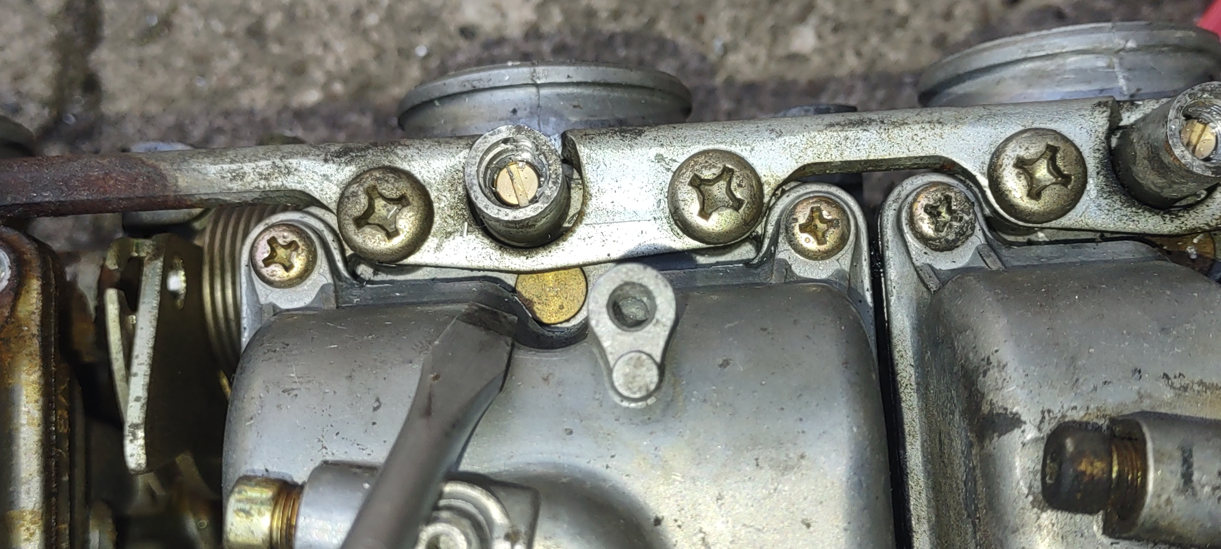

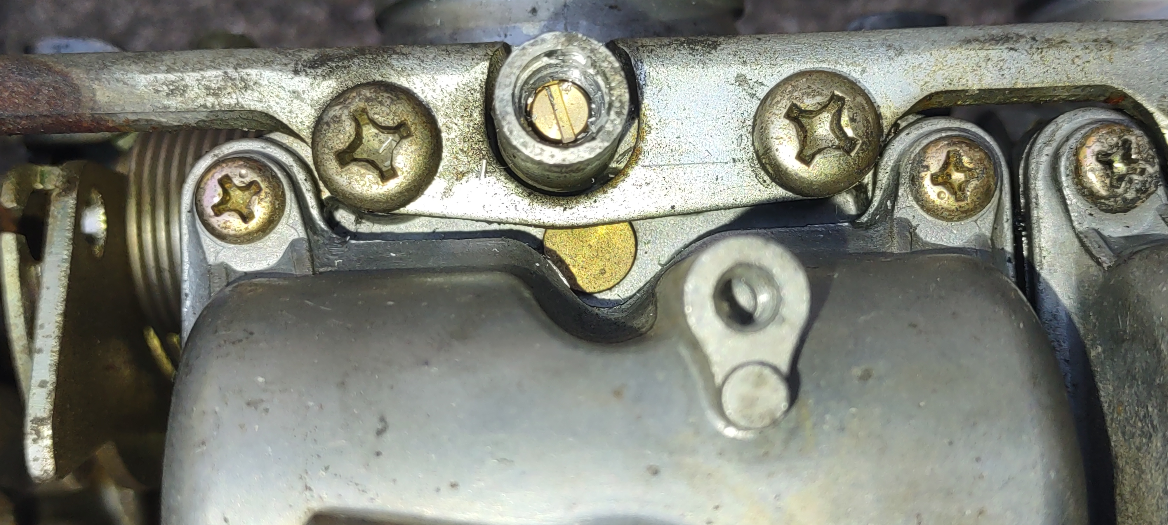

Also, anyone have any tips for the best way to safely remove the metal caps? (pictured/
Thank you in advance for any help someone can provide. I bought the bike a week ago. Number 2 and 3 cylinders are not firing so Pulled the right hand side coil and have a new coil, wires and plugs on the way. The carb boots (engine side) could not seal tight so ordered new ones to install and the pilot jet must be dirty because its a pain to start and idle. Figured its best to get everything the way God intended and not abuse and neglect such a fine machine.
- Posts: 991
- Has liked: 100 times
- Been liked: 257 times
Re: Rebuilding Carbs, Where Do These Go?
Yes you are correct the 2 clear tubes which travel over the top of the lower air box and aim downward to the ground are NOT connected to anything. They are atmospheric vents for the float bowls and face downward to prevent water entry into them.
Carefully drill a small hole in the center of the plug and then you can use the tip of a wood screw to grip the plug for removal. The plug is merely an interference fit onto a shoulder machined into the carb body. You may have to tussle with it but it will come out. Just don't drill too forcefully/fast or too deep as the brass air screw is under it and could be damaged.
An ultrasonic cleaner is the best way to clean those minuscule interior idle passageways.
Good luck with your repairs.
Great, thank you for excellent tip on the pilot screw adjuster. One more question then I should be out of your hair for awhile. In the pictures I posted below, right below the silver pilot caps ( which were removed today) there are what appears to be brass caps. Im pointing my flat head screw driver at one in the picture. Do these come out too? If so, do I also drill them and remove them same procedure as the silver ones? I wasnt planning on separating the carbs as I was under the impression they were next to impossible to reassemble for some reason. But it looks like Im going to have no choice but to separate them all.
- Posts: 991
That is a blanking plug for factory drilled passageways I have come to know as a "Welch" plug and unless one has a direct replacement ready to install back into the recess the plug fits into, and a history of having done this previously on some other similar piece of equipment, I would suggest leaving them installed as is. Normally the ultrasonic cleaner and compressed air will get anything that the plug may be covering.
The carbs really are very simple to disassemble and reassemble on/to the rack. The only connections beside the throttle plate operating spindles are the fuel rails and bowl vents. Before doing any disassembly carefully observe and familiarize oneself with how the throttle plate mechanisms interact with each other: 1 to 2; 2 to 3 the main mechanism; and 3 to 4, similar to 1 to 2.
Also, lots of pics help and record any change in the throttle plate adjusting screw positions, if needed, before disassembly.
Be certain to replace the 10 o-rings on the fuel/vent rails as the most recent of this model bike is already 20 years old.
The Tech Center has lots of helpful info.

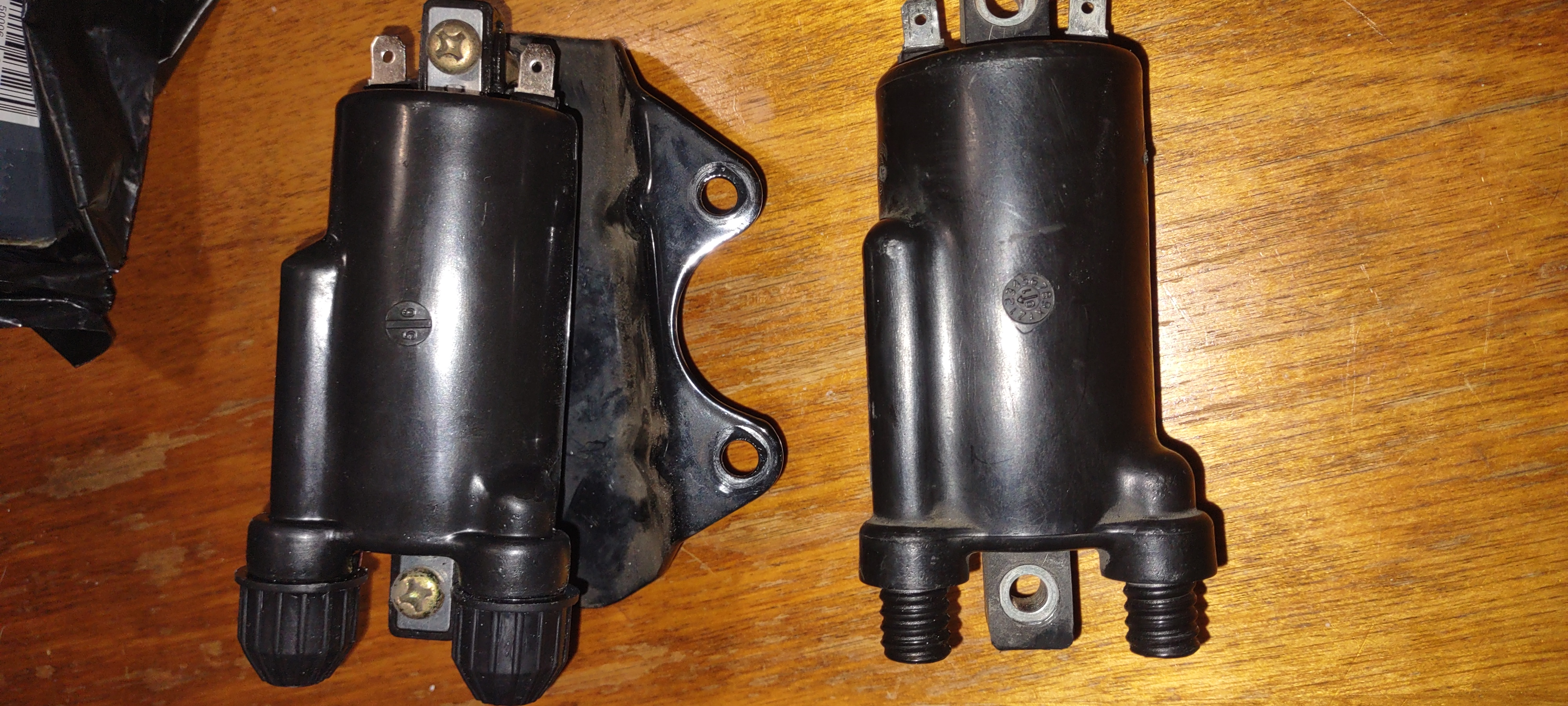

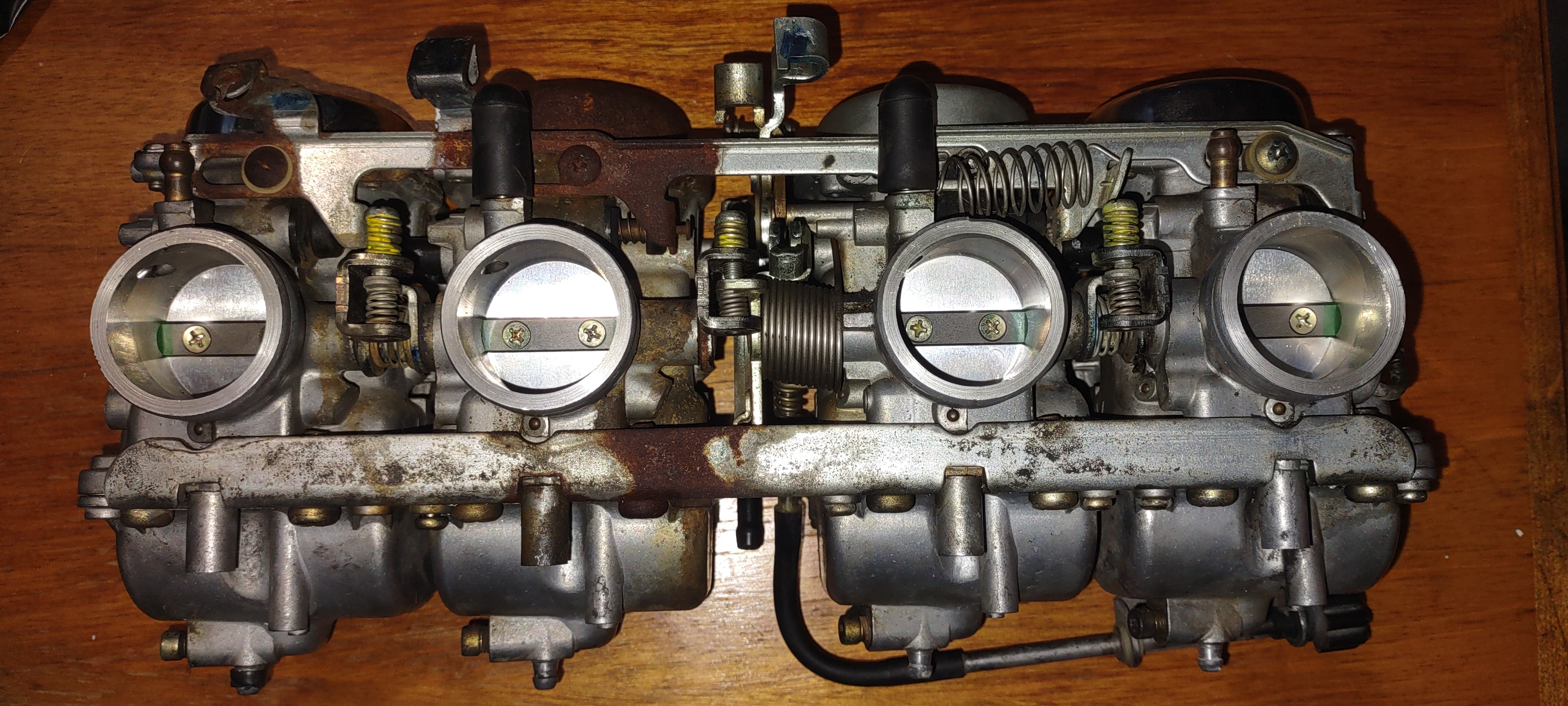

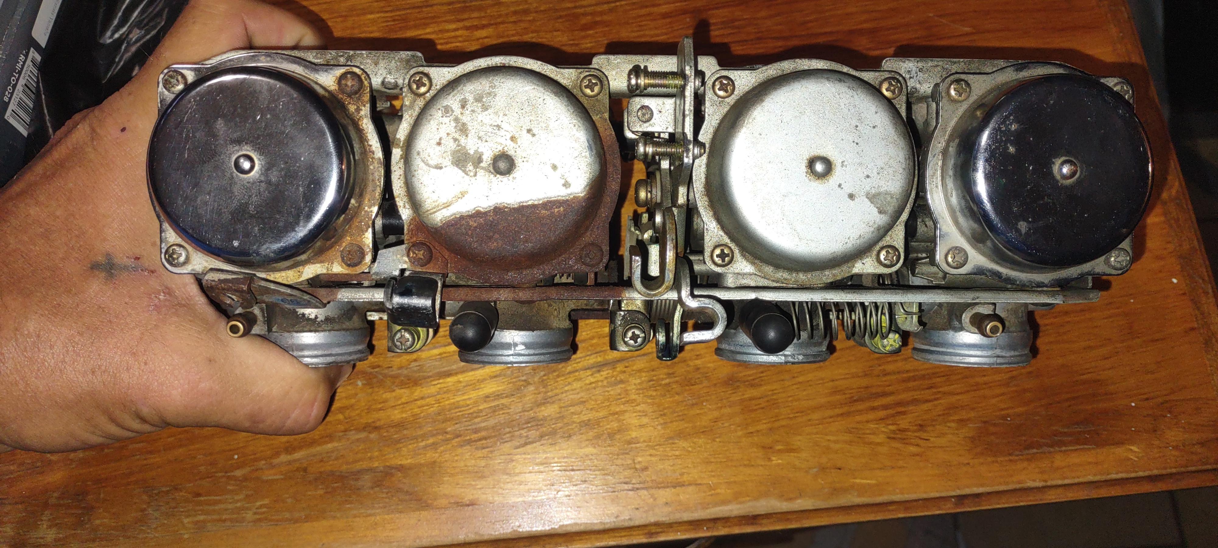

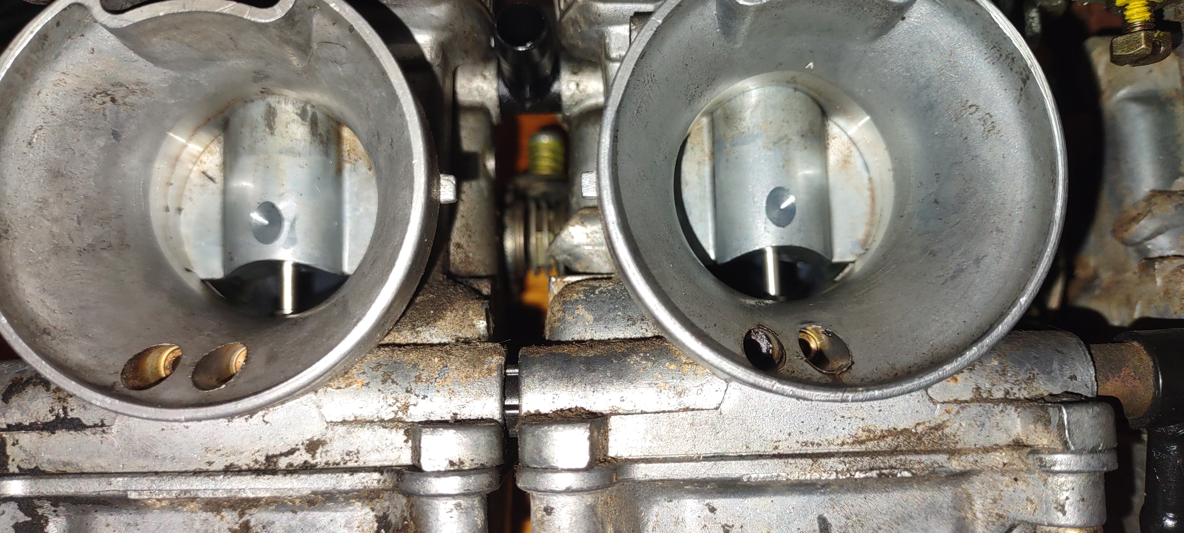

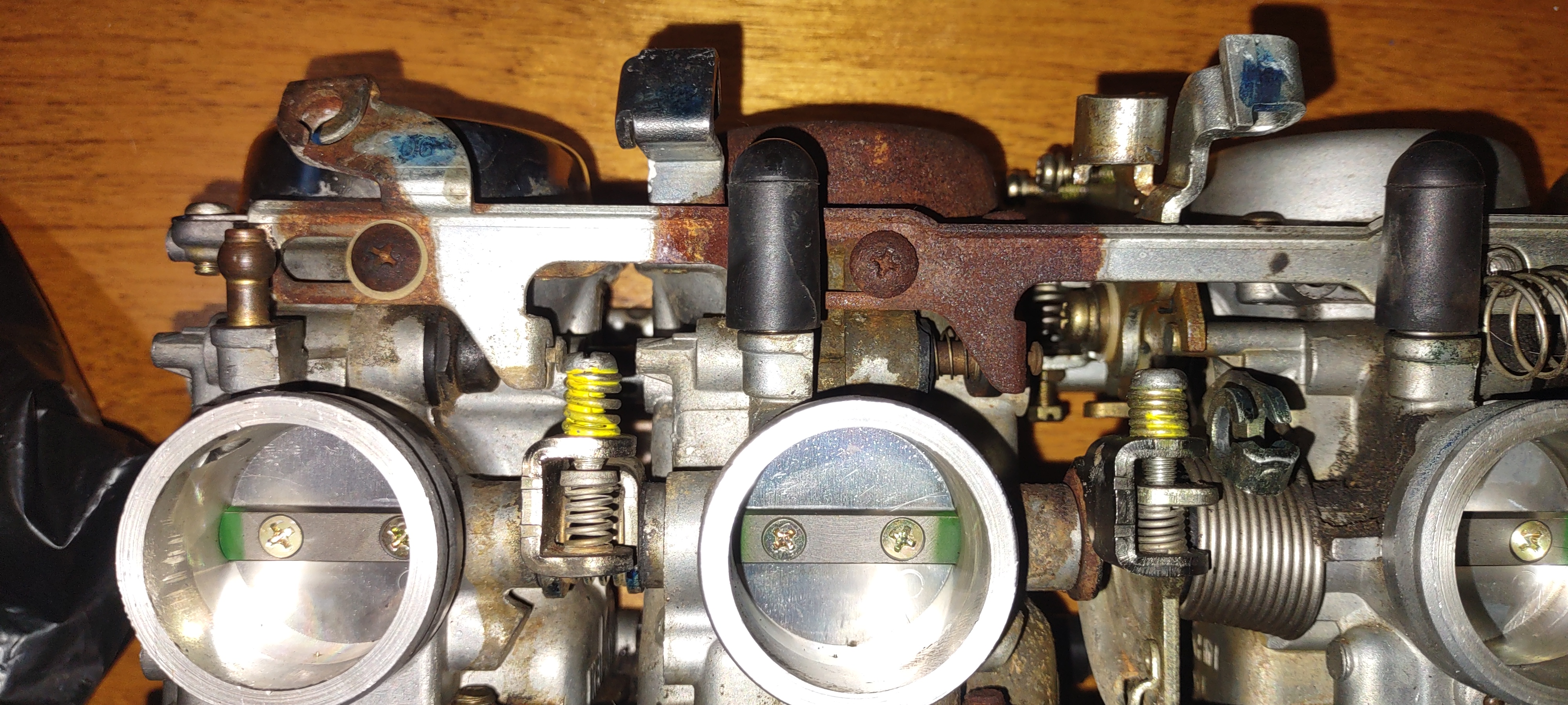

I completely agree on the carb rebuilding Nails. Only thing I wanted to do is change the pin, float needle, and bowl gasket. A good cleaning, check float heights (17mm?), button them back up and take bike the get synced. ( will bench sync them before installing though)
These carbs were operating the bike. But I could never get a 100% seal on the intake manifolds so I bought new ones. It would run really well once it was at operating temps. Well, not really well, but drivable. Super touchy to start , erratic rpms, and everything vacuum leaks and dirty pilot jets do to a engine.
After removing them its evident they're in need of a decent cleaning. But nothing ever critical was wrong with them. The leaky boots would cause my rpms to race about 1500 every time I pulled the clutch in to shift gears. Was really bad on 2nd into 3rd, would have to get to high speed 2nd, let off throttle 100% and let rpm drop as low as it would drop then shift into 3rd. Then I dropped cylinders 2-3.....
Shitty running carbs, and just dropped a coil. Time to start taking big girls' clothes off. And here I am.
I took a chance on a no name coil I found on Amazon for $21. Really not sure if its going to work out but my understanding is that it doesn't matter if its a 1-4 or a 2-3 coil, they are going to fire when the bike tells it too. You can have 1-4 coils on both sides but will all fire correctly? I hope so because as the new coil is a exact match in appearance, there was no specs as far as 1-4 or a 2-3.
So the plan for now is cleaning the carbs, new pin and needle, replace boots, replace vacuum lines, fuel line and filter, clean elec connections while exposed, install the coil, new wire and plugs. Three new sets of brake pads are sitting there waiting too. Bought a pump for the air shocks but they sent a 0-300psi. Waiting on a 0-60psi now. Haven't messed with the shock oil or seals but that will come later. Going to throw Progressives on the back and rebuild the front as needed. Already changed the final drive oil. Havent done any spline or drive maintenance but plan on it when the new rear tire goes on. Changed the oil with Rotella T^ 15-40, but that brings me to my next question...
When my 2-3 coil dropped I was 26 miles from home. It actually was barely perceivable. But I did catch on within a few miles. 1 and 4 exhaust are puffing, 2 and 3 are sucking air. Question is, riding it 26 miles home, is it possible that the unfired gas was getting past the rings and into crank case? I swear it seems to me the oil level ( on center stand ) looks higher. I think I am going to change the oil again before it gets any run time. Just the thought of gas in the oil, in the bearings....cringe. Would driving it 26 miles on 2 dead cylinders hurt it? Its hell getting a bike towed here, just went through it, so took a chance and boogied home.
I still have tires to replace to get the inspection. Hoping they dont flunk my rotors. They pass thickness wise but they looking pretty groovy. And not in the fun way. Ive been bleeding money over it and just want to get passed this initial "pay til ya bleed" phase and get some ride time this summer with a happy bike and safe. Then this winter I can pull the carbs to send to Mr. Leo. I know when they come back my girl will be a proper dance partner and big girl will cut the rug right on by those cutsie guys on their cute lil scooters. While I drink my coffee and listen to the morning news.
Thank you guys for all of the help and experience. I plan on keeping the bike til either me or her dies so want to eventually get her all back like MaKaw birthed her, so Im sure im going to try to pick alot of brains here.
Pictures attached to just show general condition of carbs. New coil has bracket installed. Paid 21 bucks for it, fingers crossed.
- Posts: 1748
- Has liked: 221 times
- Been liked: 592 times
Yes, the two coils are identical, having a reversible mount (as you surely noticed).BackTrackBug wrote: ↑Sat Apr 29, 2023 5:01 pmI took a chance on a no name coil I found on Amazon for $21. Really not sure if its going to work out but my understanding is that it doesn't matter if its a 1-4 or a 2-3 coil
After-market coils, not so much. You'll probably find that the wire caps won't work with your spark-plug wires.
I think the fuss about over-inflating the shocks is over-stated. I haven't had any problems using a gas-station compressor carefully. I generally over-inflate a little and bleed back to what I want. Hell, when I bought it my bike had some outrageous pressure in the shocks without any damage.BackTrackBug wrote: ↑Sat Apr 29, 2023 5:01 pmBought a pump for the air shocks but they sent a 0-300psi. Waiting on a 0-60psi now. ... Going to throw Progressives on the back and rebuild the front as needed.
The stock shocks work great with fresh oil. And you can refresh the oil instead of having to replace the whole shock. I'll keep the stock shocks until they start to leak. Put your Progressives in the forks instead.
I just did a whole lot more than that, limping and eventually hauling mine back from South Dakota. Guess I'll find out when I get a chance to tear into it.
From your description, I suggest that you get a compression check. That's kinda difficult on these bikes because of the deep sp wells.

I took a second round on the coil and fixed the issue. The positive side spade needed to be crimped tighter to make good contact with the tab on coil. A oversight on a simple fix. Now both 2 and 3 plug wire is firing off correctly.
