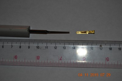

Remove/disconnect the Light green/Red brass terminal from the white plastic connector of the RLU and tape it up so it does not short out to ground anytime as it is live 12V. This cancels the power to the dash warning light when a H/L bulb with less than 50/65 watts is used and the dash warning bulb of the RLU wants to illuminate. With this wire disconnected both high and low functions of the H/L bulb will work as normal, but you will not have any dash warning if the low beam ceases to function.

Also I have included a photo of the tool which makes removal of the brass terminal so easy.
