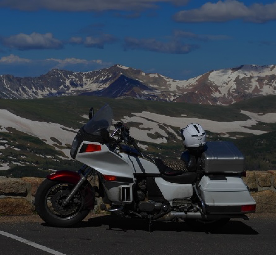

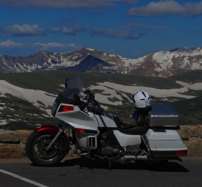

For the seat, I recommend an Air Hawk. About 2/3s of the way into a 3500 mile ride, as my butt was negotiating terms of surrender, I bought an Air Hawk at some shop in Ohio. The next day, far from recovered, I rode twice as far as ever before. I was reluctant, but it just works. The cheaper knock-offs probably do, too. ( I stuffed mine under beads, where it's been ever since.)
Yeah, I also really tried to like the floorboards. They suck IMHO -- my size 9s wouldn't fit between them either. I got tired of riding pigeon-toed. As a side benefit, I can take corners so much better balancing on the balls of my feet. (I think some XII came from the factory with floorboards.)
I think the trunk extender moves the trunk back, but not the back seat.
I converted my XII to ride solo. I fabricated a butt pad like the front of the stock back seat, then dumped the back seat. I also fabbed a back rest, which I couldn't live without now. I dumped the trunk, using a suitcase instead. And rather than move it back, I moved it forward -- mass centralization. (I think there's also less turbulence than from the trunk.)
I'm 5'8" and like a more compact cockpit -- used to dirt bikes. The butt pad is about at the middle setting for the stock back seat -- not all the way back. The handlebars are about 2" narrower than stock (each side -- 4" total). I made it mine, and I like it fine.
It's all bolt-up so I can put it back. And save the backrest for another bike.
