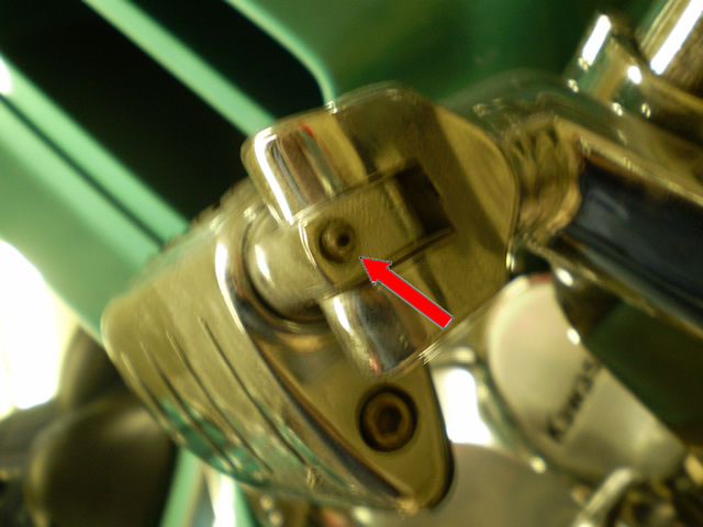

If they are the same that Marvellas sells, which I imagine they are, they ARE able to be adjusted from the bikes center line. There is a small allen screw head that you should be able to see that will adjust that on the back side edge of the peg. I got mine from Marvellas at an AVA Rally (where he also installed them free) and I adjusted mine that way.
Can't find the adjustment screw you refer to. These are the pegs I have. Kuryakyn #7976:
Ron in Oregon

Those look like the ones I have. Fold the peg up and look on the edge of the peg towards the bike, I think that is where it is at, you have to look a little hard to see it. You back that allen head screw in or out to adjust the angle the peg will stay at.

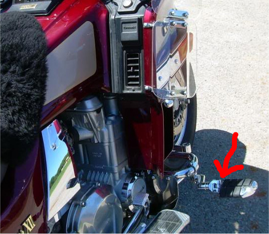

Here is the best pic I could find of them on the voyager.
See how I have them rotated near the mounting bracket so they can be swept back a little.  In your photo the foot pad is lined up with the pivot point.  Mine is not.  They really are almost infinitely adjustable.  Some of the adjustments are hidden pretty well.

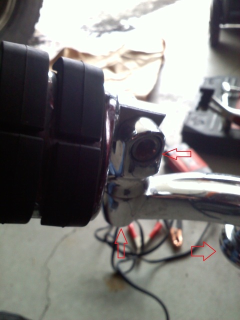

here is a picture of where my foot pegs adjust at.
Most adjustment points for pegs. Click on pic for larger view.
