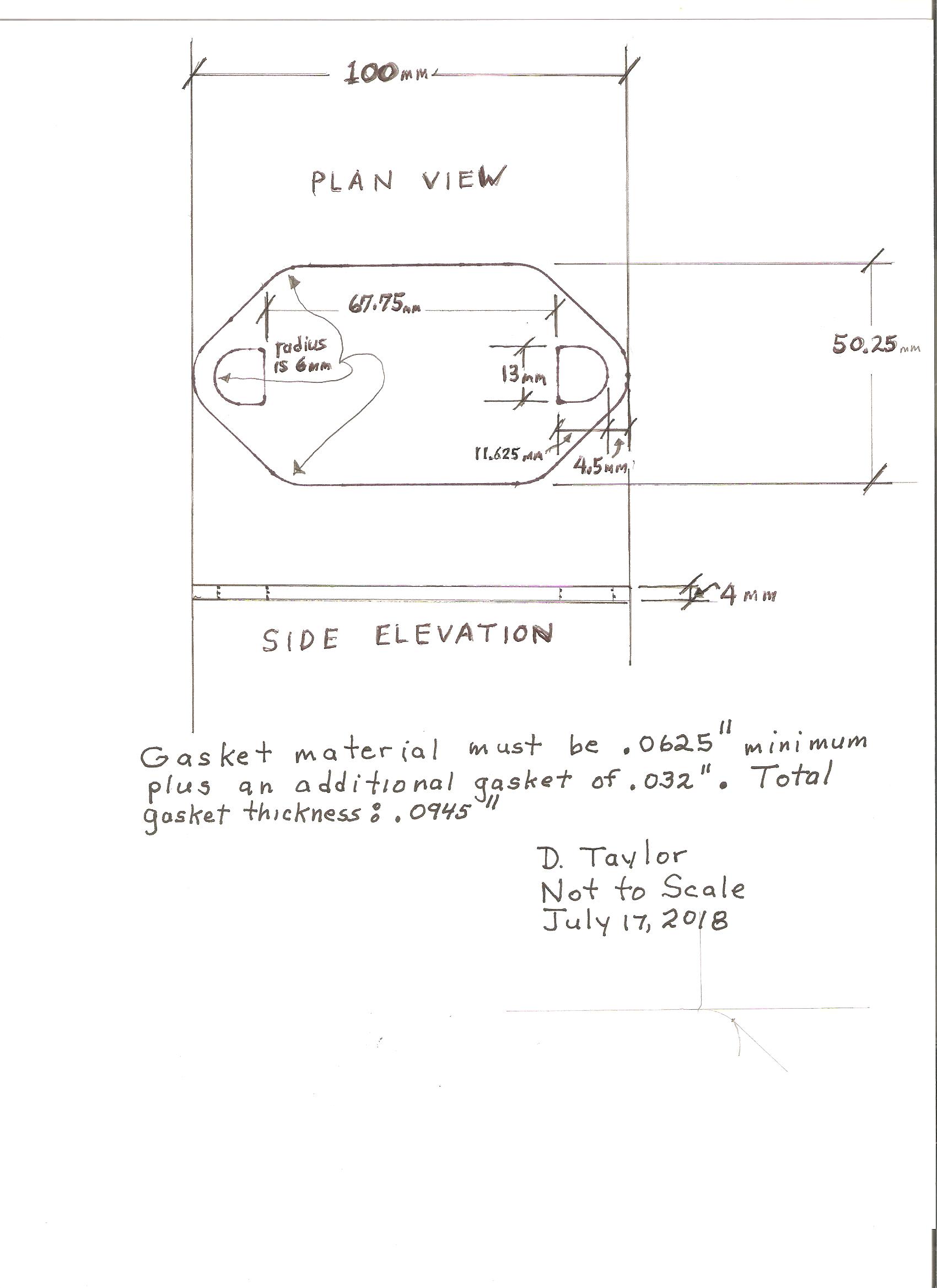

The Canadian Voyager XII units were NOT required by Canadian environmental law to be as hosed up so to speak for addition of clean air to the exhaust gas ports, nor were our models required to have fuel vapour entrapment such as the California model Evaporative Emission Control System requirements. This resulted in a considerable lack of plumbing on the Canadian models. A blanking plate was installed on each side of the cylinder head cover in place of the "Clean air" reed valves and hose connection ports and none of the valves or hoses to the hose ports were required on the Canadian models: see service manual pages 1-17; 1-18; 1-19; 2-4; 2-19 and 2-20.
In fact, the Canadian models had NO hoses to/from the carbs except for the float chamber vents, the ignition ecu vacuum advance hose from #1 carburetor and the float bowl drain hoses.
The 4 brass vacuum nipples on the rear of the carb bodies had 4 of the rubber blanking off caps.
Thank heavens we did not have all of the plumbing the California models did for the EECS.
In a prior post I posted dimensions for the blanking plate should anyone wish to make one. Note a thick gasket must be used for this plate but I think I made note of that on the plan.
Edit: I found the plan.
