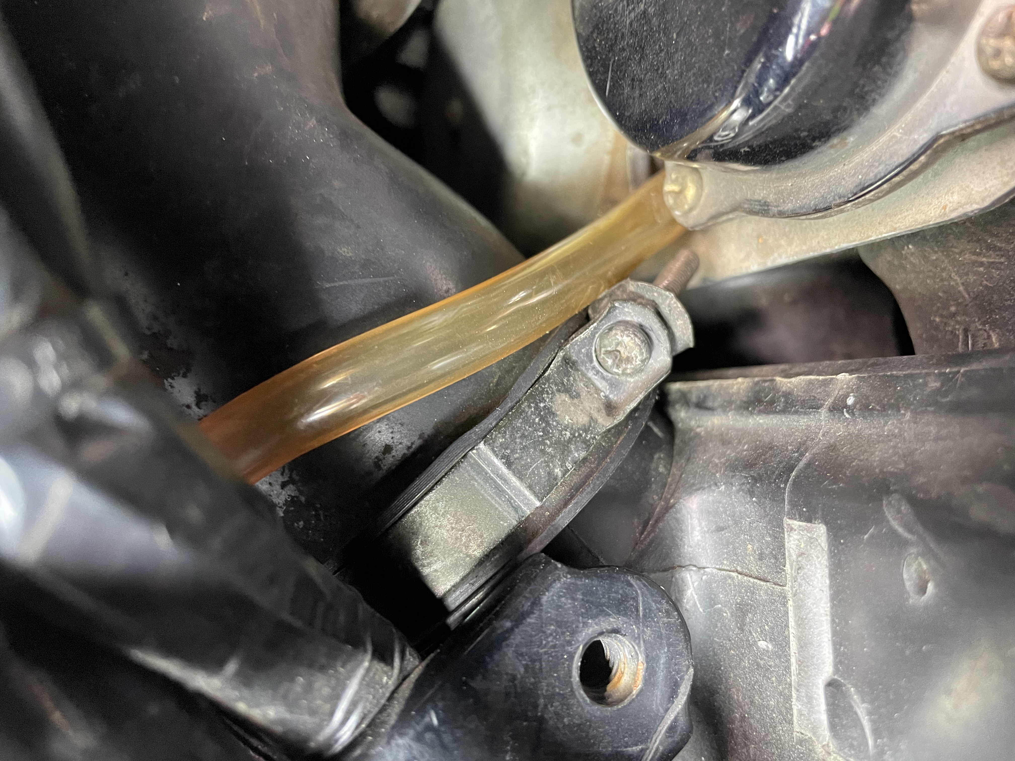

See viewtopic.php?p=96093#p96093. The fuel-line tee rolls over the same as the vents, but it's stiffer and more difficult to slip onto the tee. Keep smiling.

Should be a medal given if you find a way to do this without giving up after a couple hours. I like the hemostat idea.
It is truly a test of patience and stamina. Haha
Nails wrote: ↑Fri Jul 21, 2023 9:34 pm See viewtopic.php?p=96093#p96093. The fuel-line tee rolls over the same as the vents, but it's stiffer and more difficult to slip onto the tee. Keep smiling.![]()
