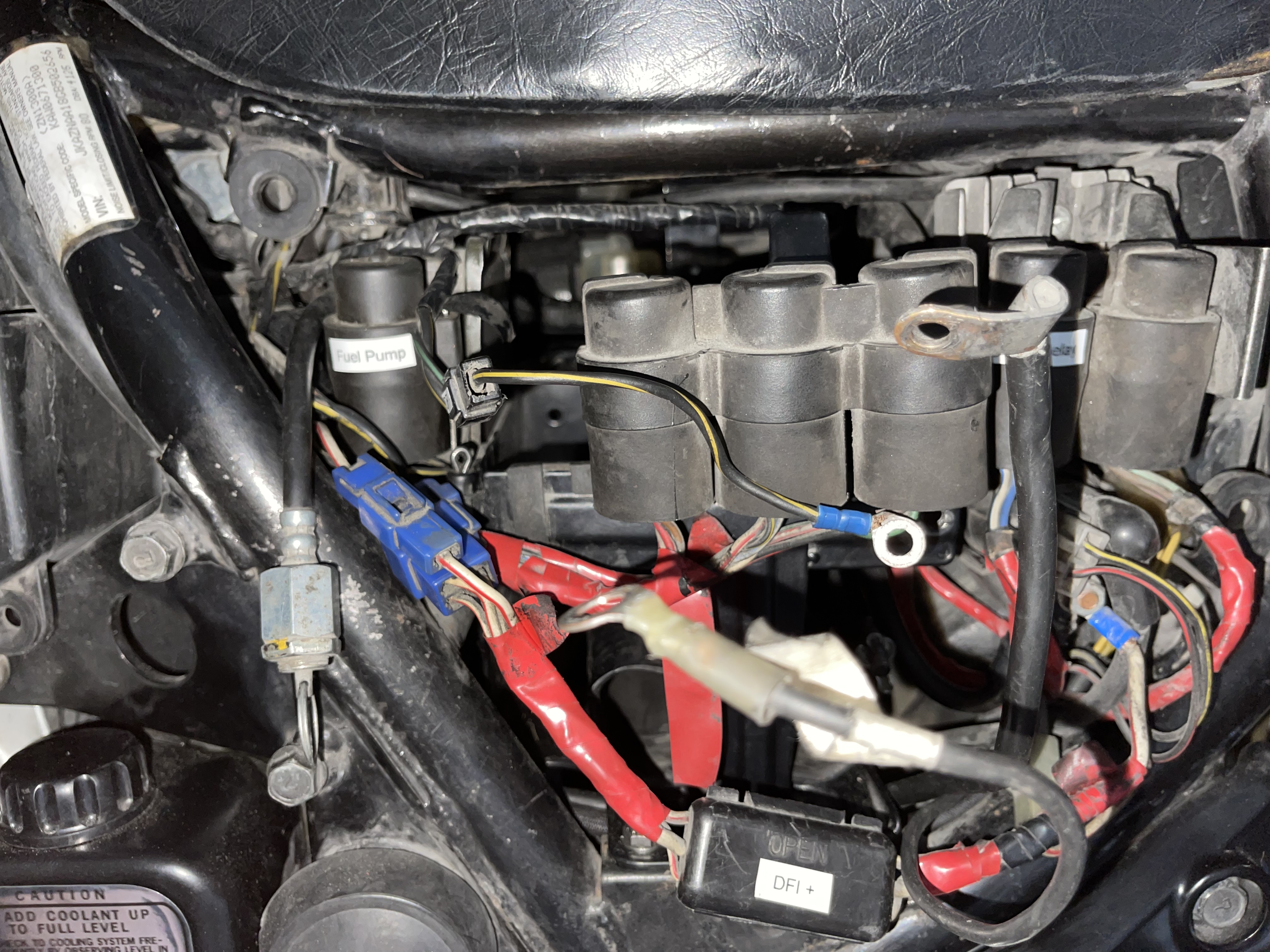

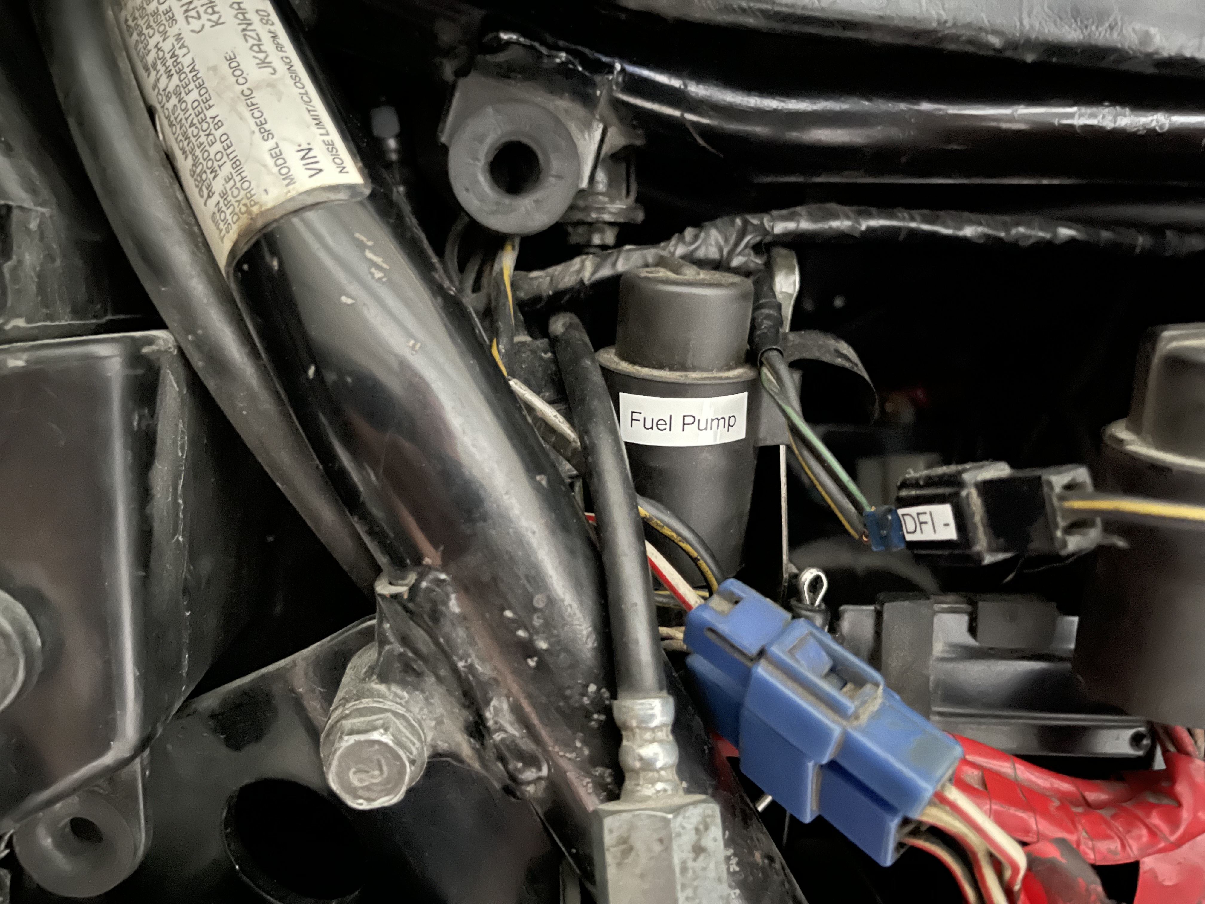

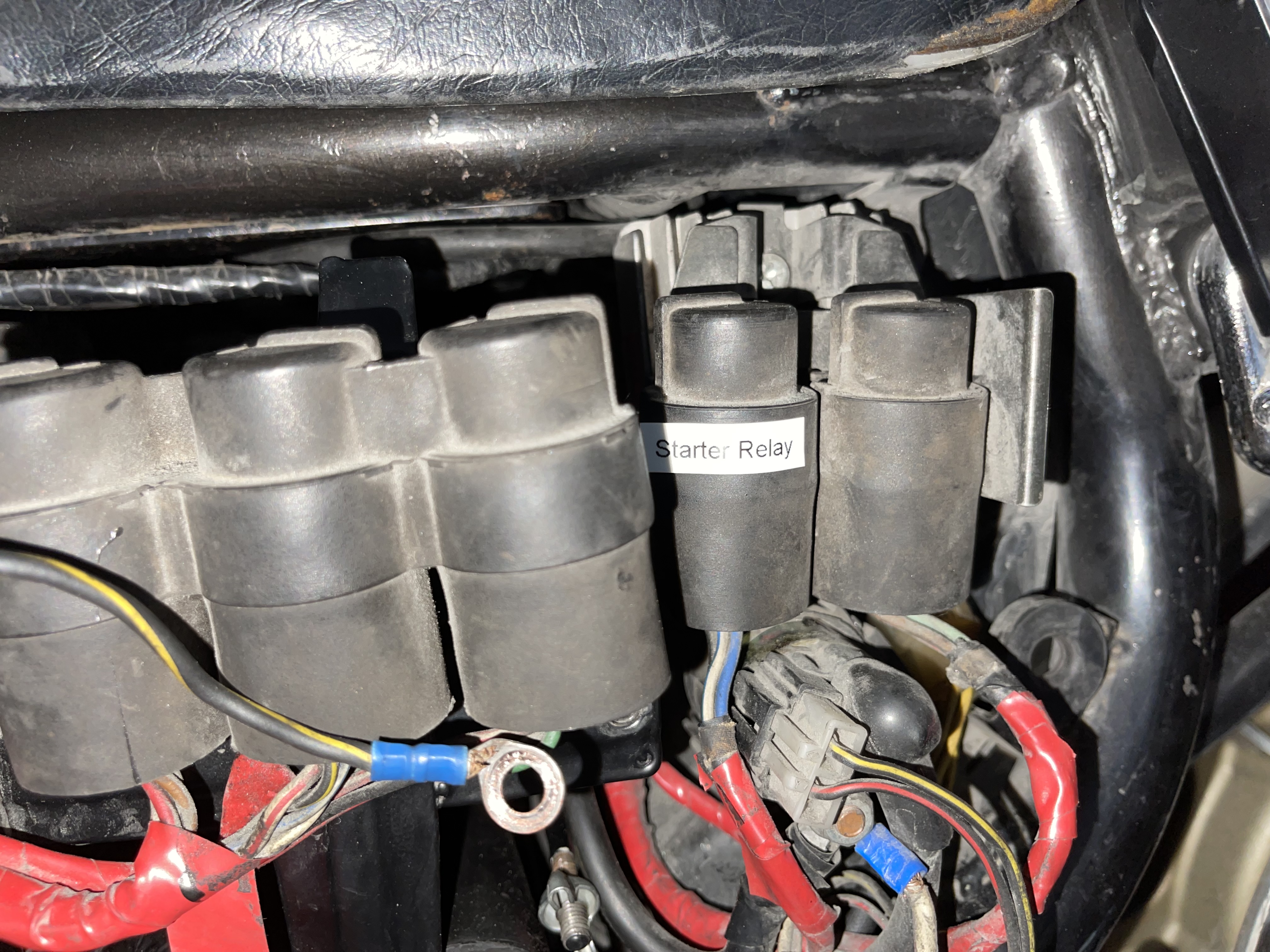

- jorgeno
- Posts: 82
- Joined: Wed Apr 12, 2017 5:05 pm
- Current bike(s): Kawasaki ZG1300 1986
Kawasaki ZN1300 1986
Suzuki GS1000G 1982 - Has liked: 0
Re: NO Power to Fuel Pump!
I only referred to the manual, but thanks
