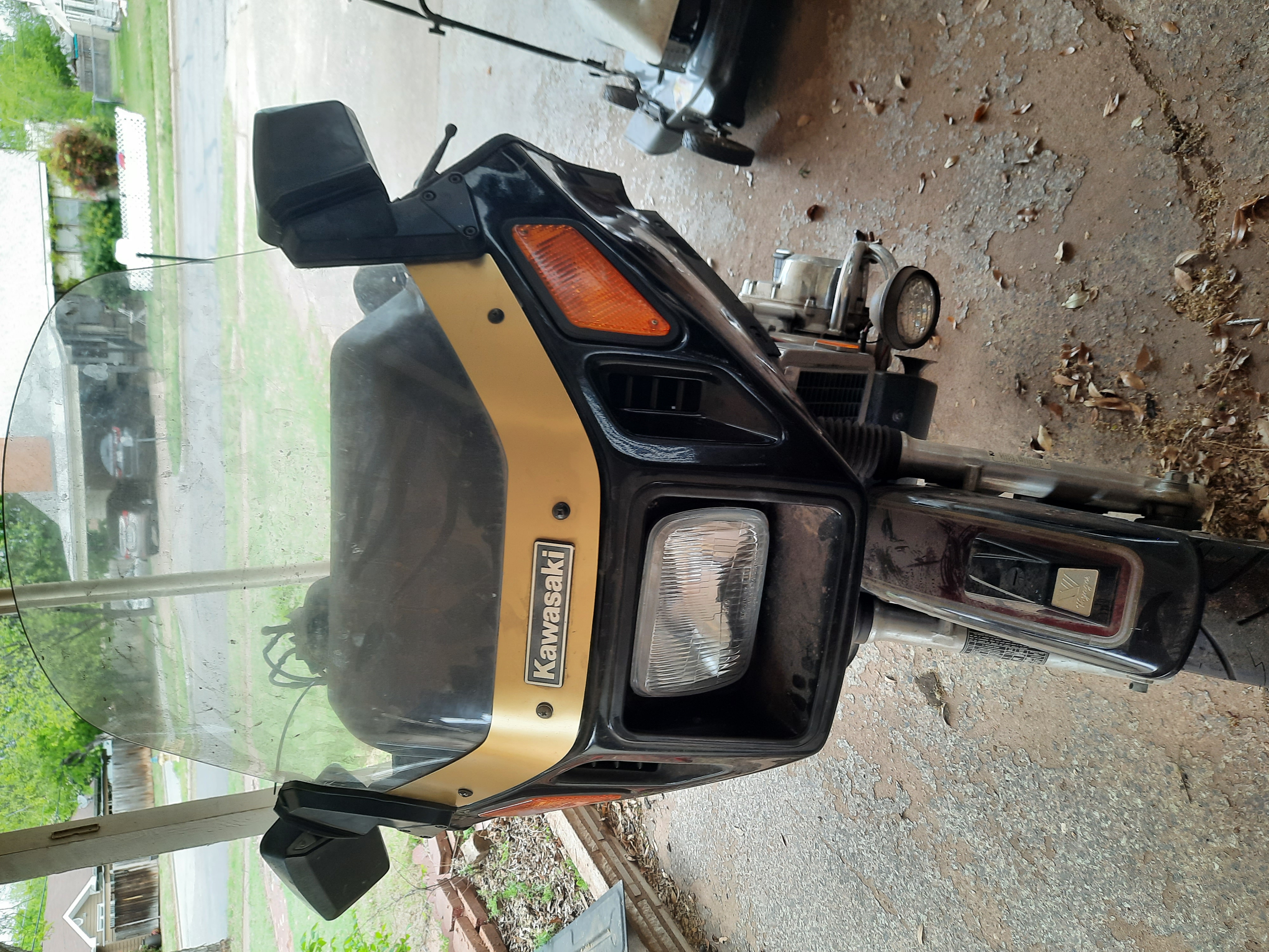

Its sat inside since 2018.pretty clean.i thought it was a voyager 4 cylinder. Apparently its a kz 1300 but dressed up like a voyager. So i guess: transmission fluid 1 tbsp down each plug hole. Replace any plugs that need it.let sit 24 hours. Change oil filter radiator coolant. I assume it has one. Pull tank off, rinse it out, put gas in, swish it around, then remount.change fuel filter. Change brake fluid. Install new battery. Fingers crossed see what happens.130 hp according to specs.

Ok I understand your confusion. There are three different series of bikes all called "Voyager". You might find this helpful: https://amervoyassoc.org/voyager_history.php
- Has liked: 505 times
Re: Just 83 1300
And there are basically no common parts between the three. As a matter of fact the Voyager 1700 isn't related at all to the first two series of Voyagers. As you correctly surmised, the ZN1300 Voyager is indeed descended from the Z1300. The ZG1200 and ZG1000 Concours descend from the ZX1000 Ninja. All of which descend from the various Z series bikes.
So, no matter which of the inline Voyagers you have, they are descended from some hot-sh*t screaming fast bikes, and retain some of that heritage. The ZN1300 was apparently too much, too much electronics, too much size, too much weight, and the ZG1200 Voyager XII was created to remedy that. Same comfort, lighter, cheaper, I think maybe faster because of the less weight, better handling, less complex. IMNSHO the Voyager XII is the perfect bike. I have heard VN1700 owners say that the 1700 Voyager is even perfecter ;)
