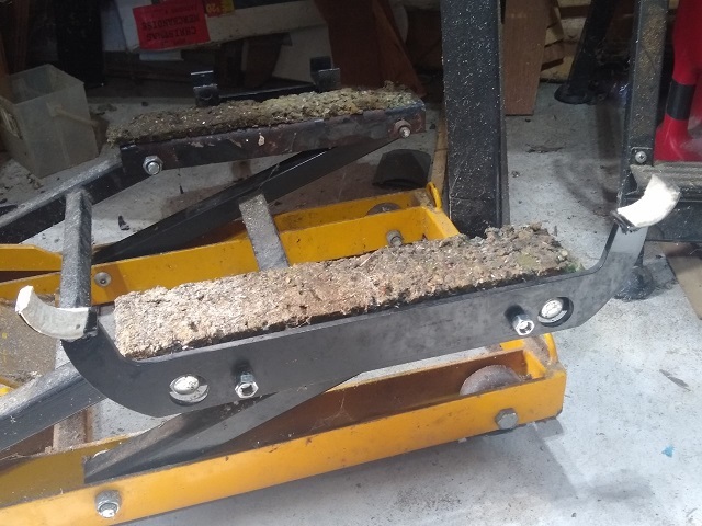

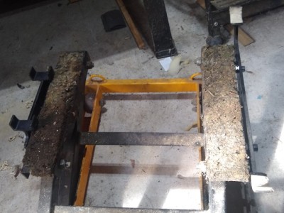

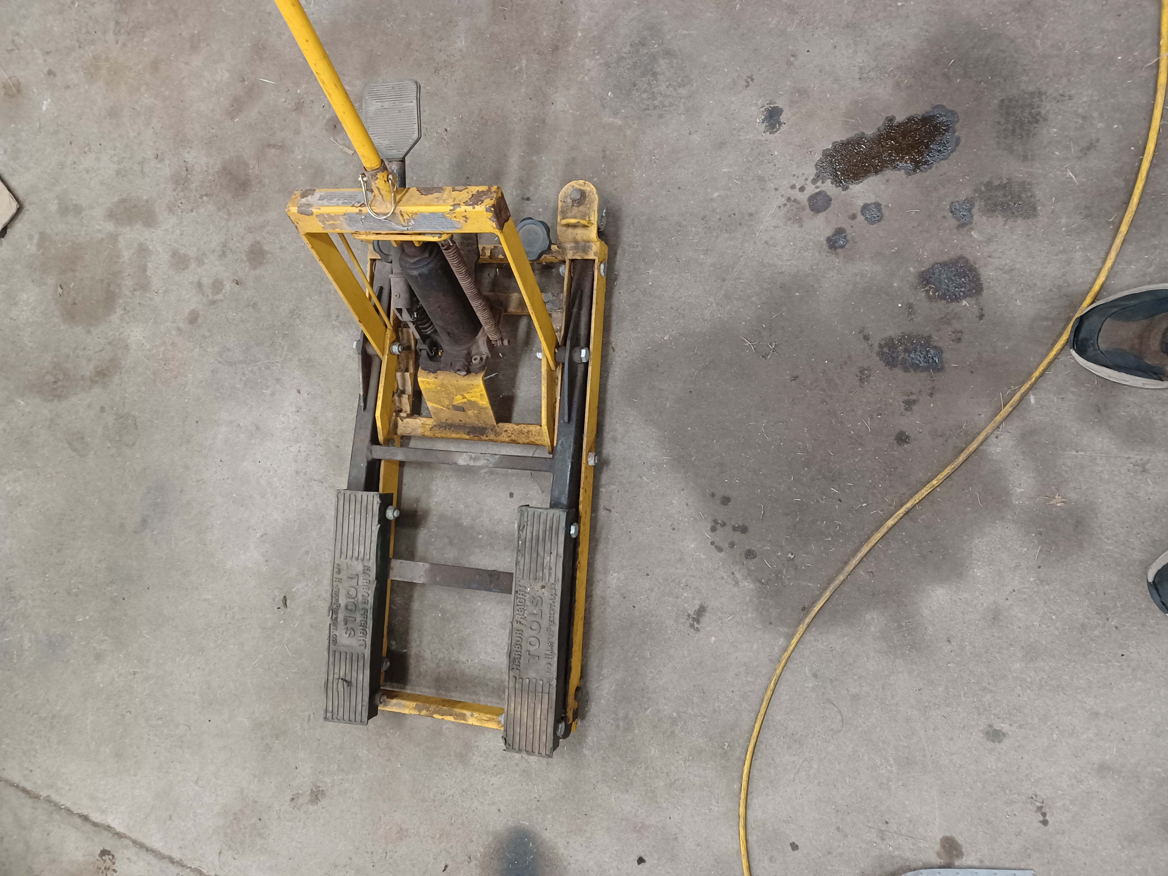

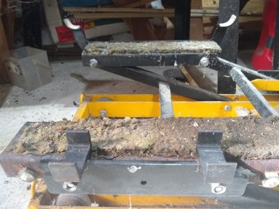

Here are a few pics of my adapter on the HF lift. They just bolt onto the lift arms and easily removed if not needed. Work great with the Voyager XII

Nice. I am going to look into making one of wood, again, come Spring. Thanks for sharing the photos. Cheers!

Well, started winter maintenance yesterday, and first on the list was taking the wheels off to get the new tires put on. Tried the jack, and honestly saw no problems with the exhaust pipes crushing, but it was WAY teetery and unstable. So that adaptor is definitely the way to go!
