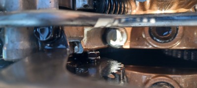

The camshaft sprocket bolts were coming undone
See photo look in the middle
